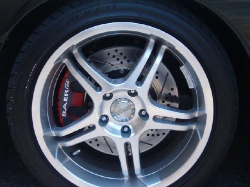

Well, to track my fatty GTO I needed some bigger brakes. I pulled of the 11.7 inch fronts and replaced them with the 13 inch Baer GT package that includes the 2 piece rotors (4 lbs less then stock), SS brake lines, massive PBR calipers, and new pads. In the rear I replaced the stock rotor and replaced them with slotted and zinc washed Powerslots. I will be using EBC yellows onthe front and reds on the rear for track use and AP551 fluid. SS lines for the rear are ordered from Stoptech. Lets just say that after I seasoned the rotors and bedded the pads, this system will suck your eyeballs out of the sockets!
Pics:
Those front brakes are behind 18 inch rims:
attachment.php

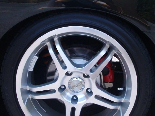

Rears:
attachment.php

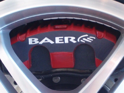

Here is a closeup of the front caliper. I got the stock black calipers because I didn't want to pay Baer to powdercoat them for $150.00 so I spent $10 and got a ceramic high temp paint and did them myself. They came out pretty good!
