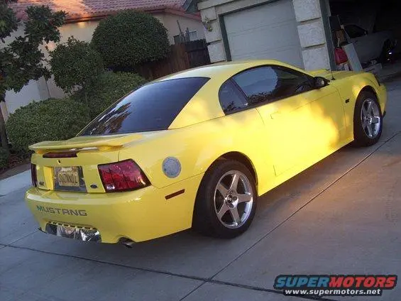

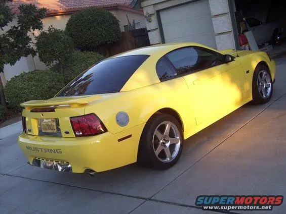

I have the Ford C-springs with 1/2 coil cut from the rear springs without it the rear only dropped about 3/4". Didn't need CC plates, overall drop about 1.5". You could pay a shop but I did it myself using these instructions took about 4 hrs. Then about another hour a week later to pull the rears to cut the 1/2 coil off. I have attached a pic of the finished product.
http://www.yellowmustangregistry.com/vogtland.html

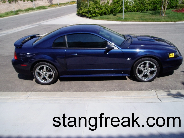

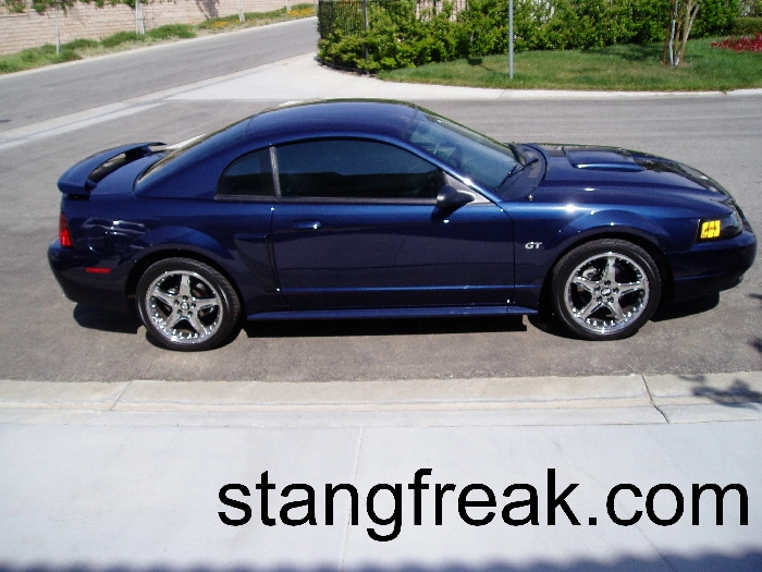

If you don't want it slammed then go with Eibach Pro-Kit. Nice drop but, not too extreme. I would strongly suggest you change out your shocks and struts at the same time for best ride quality!

ok, thanks for all the post guys. this helps a lot. i guess i just have to decide to either go with the ford C springs or eibach, which ever i pick, i think i will get them off of rbay. i'm debating if i can/should do it myself. i love all the info and pics on here. also is 1 day enough time to get the front and back done??? And i'm sorry if i didnt spell stuff right, we just had a few drinks right before we came back to our room (out of town) so you know how that goes..... thanks.
P.S. love that blue hard top GT, who ever has that, VERY NICE MAN
