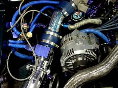

Here is where I mounted my solenoids, if you want to be discreet though mount them behind the plenum on the firewall. :nice:

94SC50 said:
I used a WOT switch so all you have to do is back off the pedal a little to disengage the spray.
Thats what the zex control unit does when its hooked up to the TPS sensor. You set the box to the WOT tps voltage and your done. Zex is a very easy and dumby proof system.
