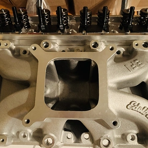

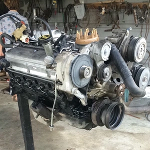

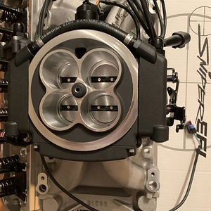

Going to break in the 331N/A & run a Holley Systemax EFI Throttle Body Injection setup with an MSD Crank Trigger Dizzy, super easy to tune fuel map’s and Spark tables, AFR, rev limiters, 2 step, yada. Comes with a handheld LCD touchscreen. Blower lead: 3 MONTH’s!!
Breaking in the 331 N/A with a Victor, Jr. EFI Intake
Now the 331’s break-in is now going to be N/A (3 Mo. 6-71 Blower lead!).So, up CR to 10.3 w/small Ch 56cc TrickFlow 11R 190’s, Lunati S.Roller Cam, Systemax. Love the Victor, Jr EFI Intake’s! Throw a Carb on, use FI ports as DP NOS inj, or OE’s EFI using a 90’ on the flange with a TB & CAI..OPTIONS!

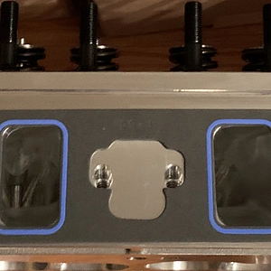

Trickflow 11R 205’s, Trimming 1250’s..
Hacking away at the Felpro 1250’s for unobstructed deep breathing.
