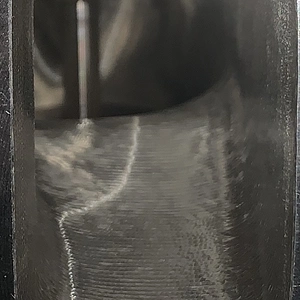

Trickflow 11R 205’s, Trimming 1250’s..

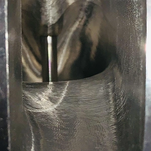

Hacking away at the Felpro 1250’s for unobstructed deep breathing.

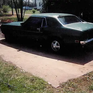

one of my favs... 70 Mustang coupe with 69 front end

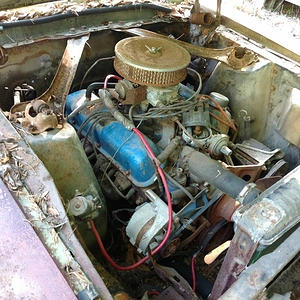

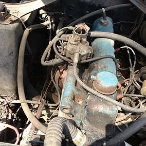

67 200ci coupe after 10 yrs sitting

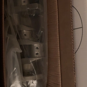

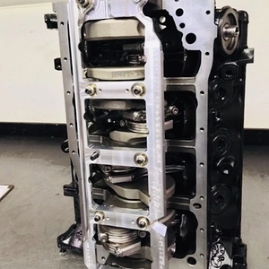

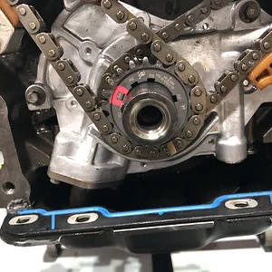

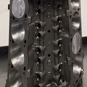

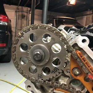

Waiting on Cometic head gaskets. Mellings pump, Pan/Pickup.ARP drive.Block Magna-fluxed, boiled, squared, decked (pistons @ 0.005 below zero deck) bored & honed with torque plates. File fit rings. Weighted all Components. Align honed block & internally balanced Crank. Mains @ 0.0020, Rods @ 0.0022.

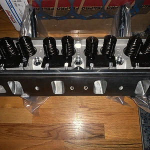

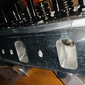

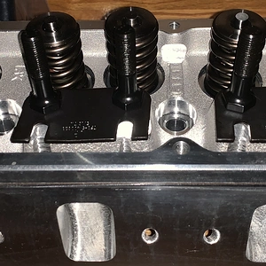

TFI 11R 205 heads, competition ported, 2.050 Int.., 1.60 Ex. 66cc chamber volume. Within spec’s. Re-cut valve & seat angles for Manley severe duty valve install. Installed springs, Retainers, 10’ locks for S.Roller Crower Cam.

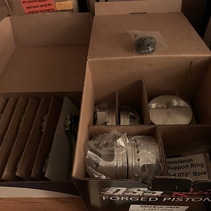

D.S.S. Forged, floating pin stroker pistons. +0.030 (center relief; unshrouded, flattop). 3/8” ARP SIR’s, bushed, will shotpeen for stress reduction. Will equalize weight of each like components of reciprocating assembly.
