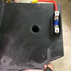

I ran the power to the amp to the side of the fuse block which was easy to access.

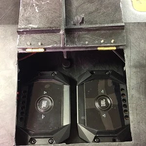

After the speakers and cross overs were mounted the door was screwed shut for concealment.

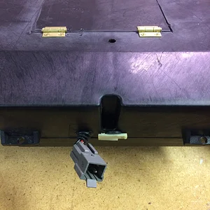

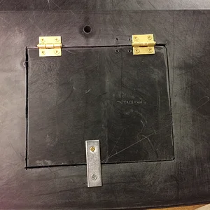

The cross overs were embedded in the baffle. I cut out a panel and mounted brass hinges for easy access after installation. I used the tweeter factory wire for the input as they were not linked to the factory amp.

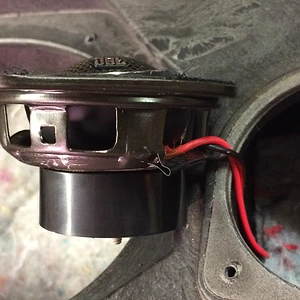

After the magnet was removed, I could use the mounting hardware that came with the tweeters.

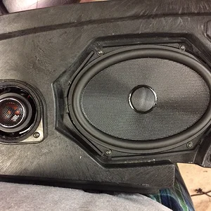

Notice that the woofer and tweeter are in the same location as the stock units. the new tweeters needed to use the stock mounting bracket to fit. Had to cut out the speaker and knock out the magnet.

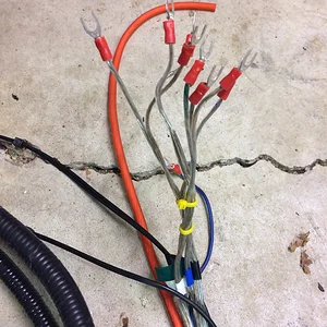

I prefabricated the wire harness so I only had to pull wires once.
