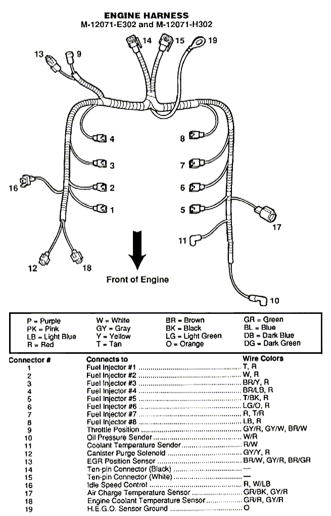

There should be an orange wire (its #19 in the picture below) behind the passenger side head that needs to be grounded. I believe this can be attached to either a bell housing bolt or one on the back of the cylinder head. I have mine on a bell housing bolt.
There is also another ground here that will cause all kinds of issues if it is not grounding well.
Thank you. I will absolutely verify these ground when I'm around the shop tomorrow!
