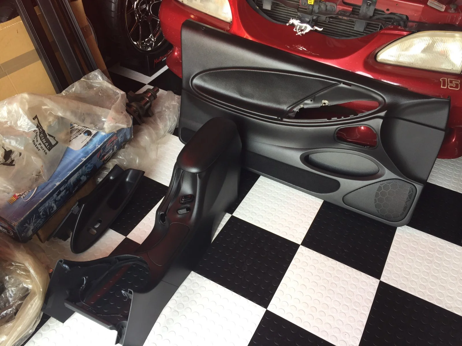

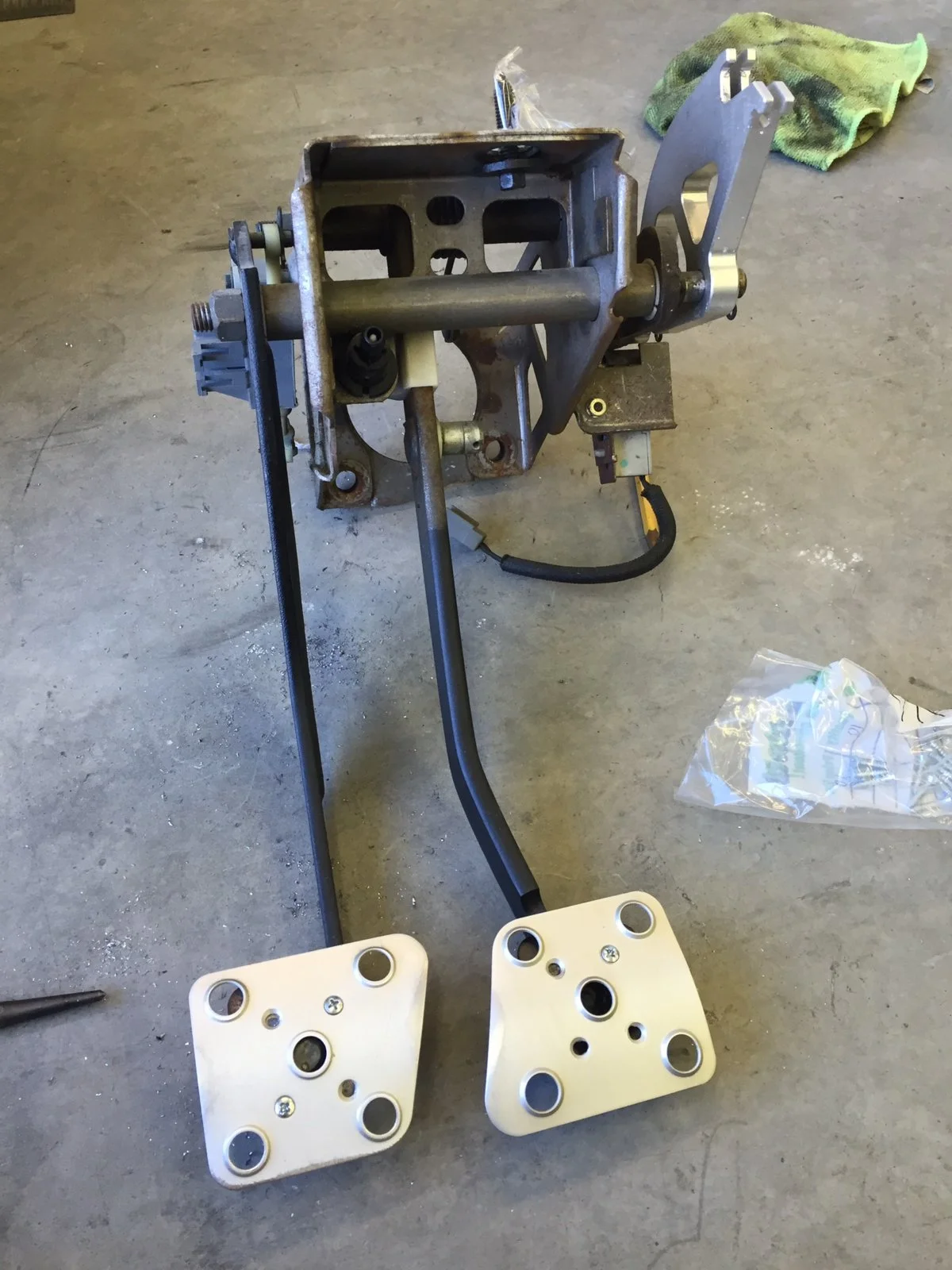

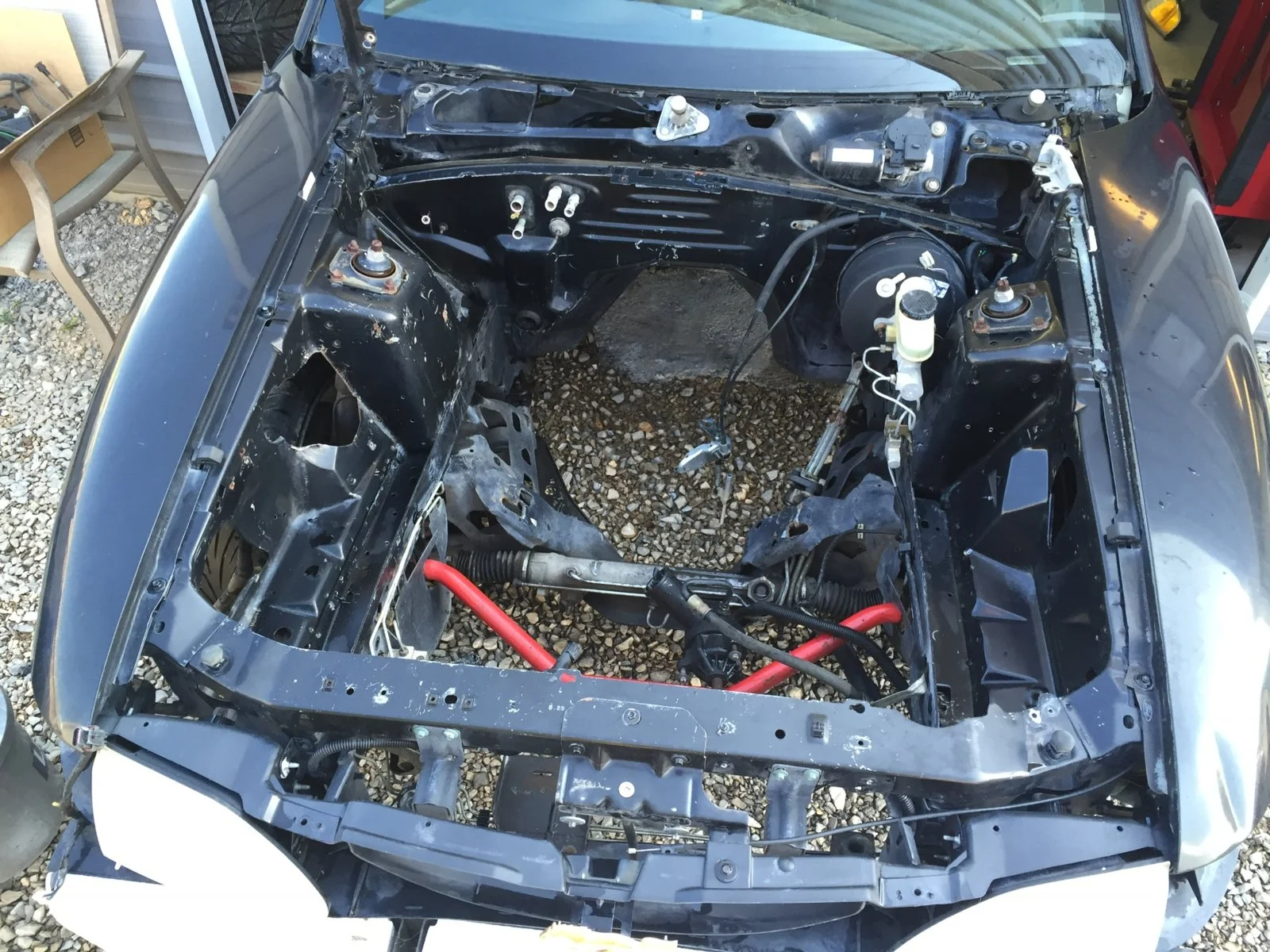

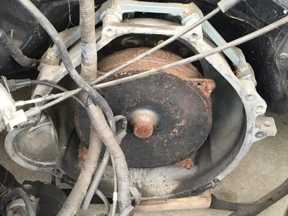

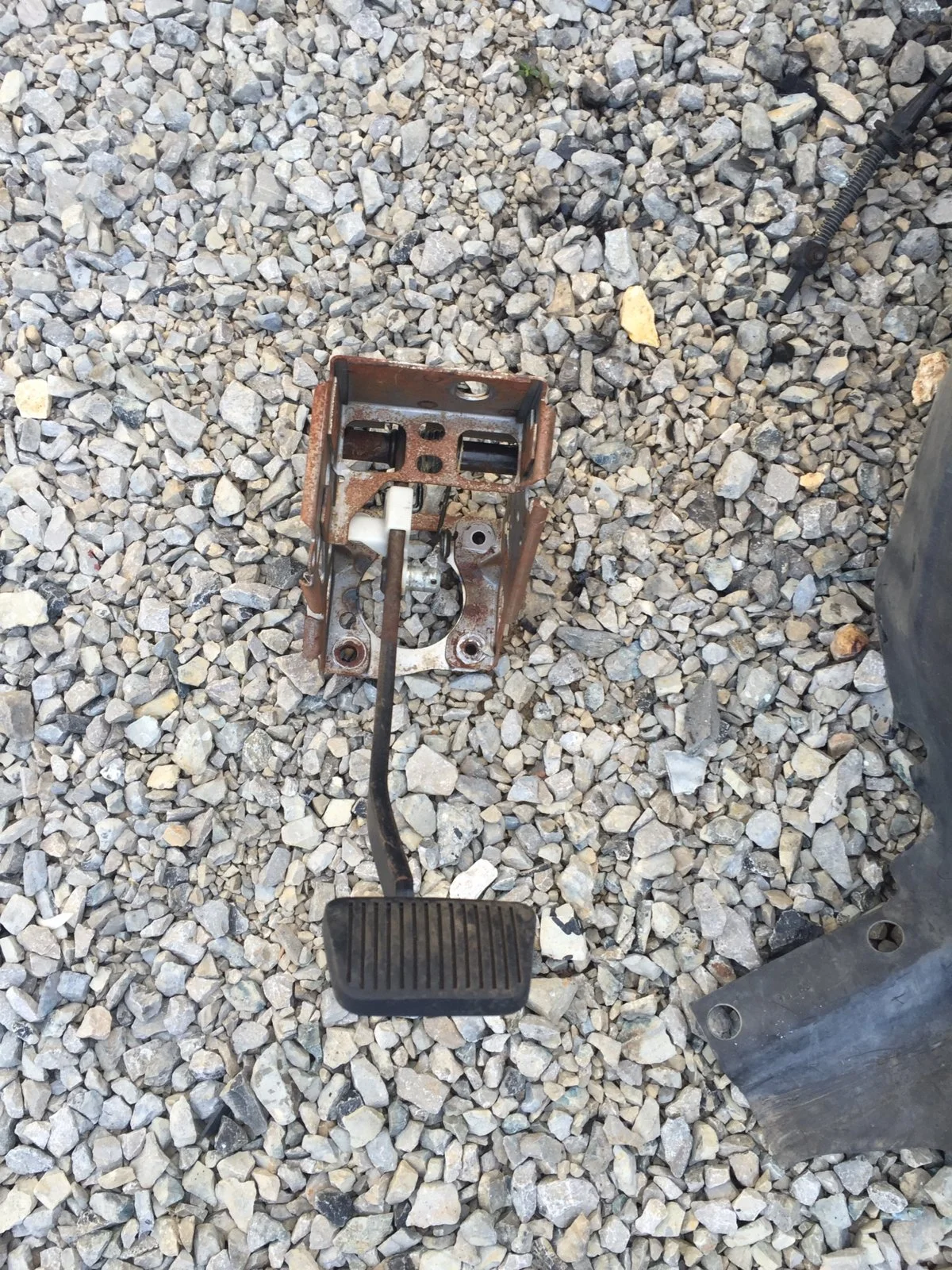

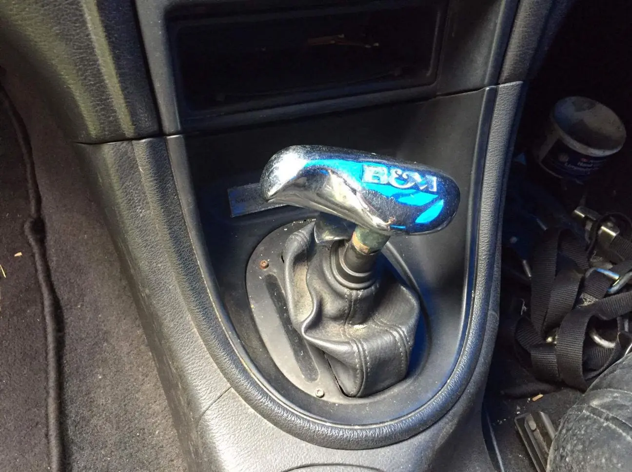

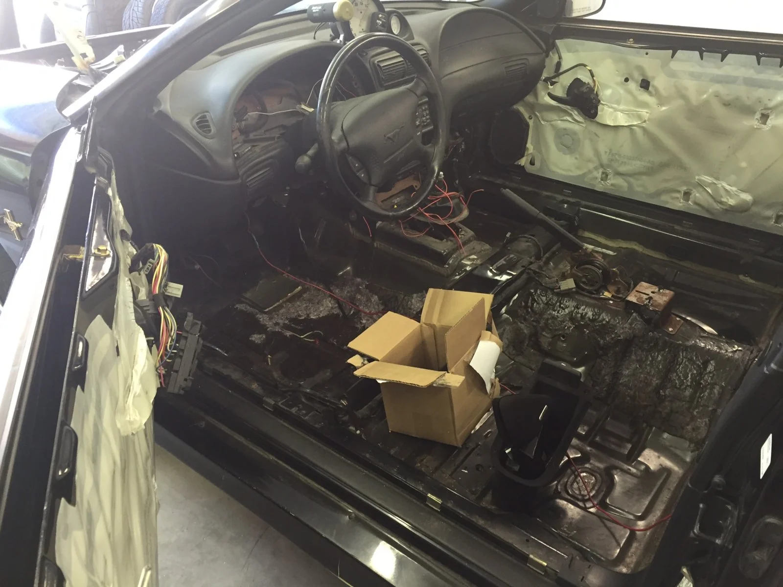

The first task was to yank this molded interior and sell some parts that won’t be good enough for this build. The car came from Saleen as a 5 speed tremec 3550 and not this junk automatic that someone has crammed in the car. So out all this junk goes. I was actually able to sell this whole setup to recoup some cash.

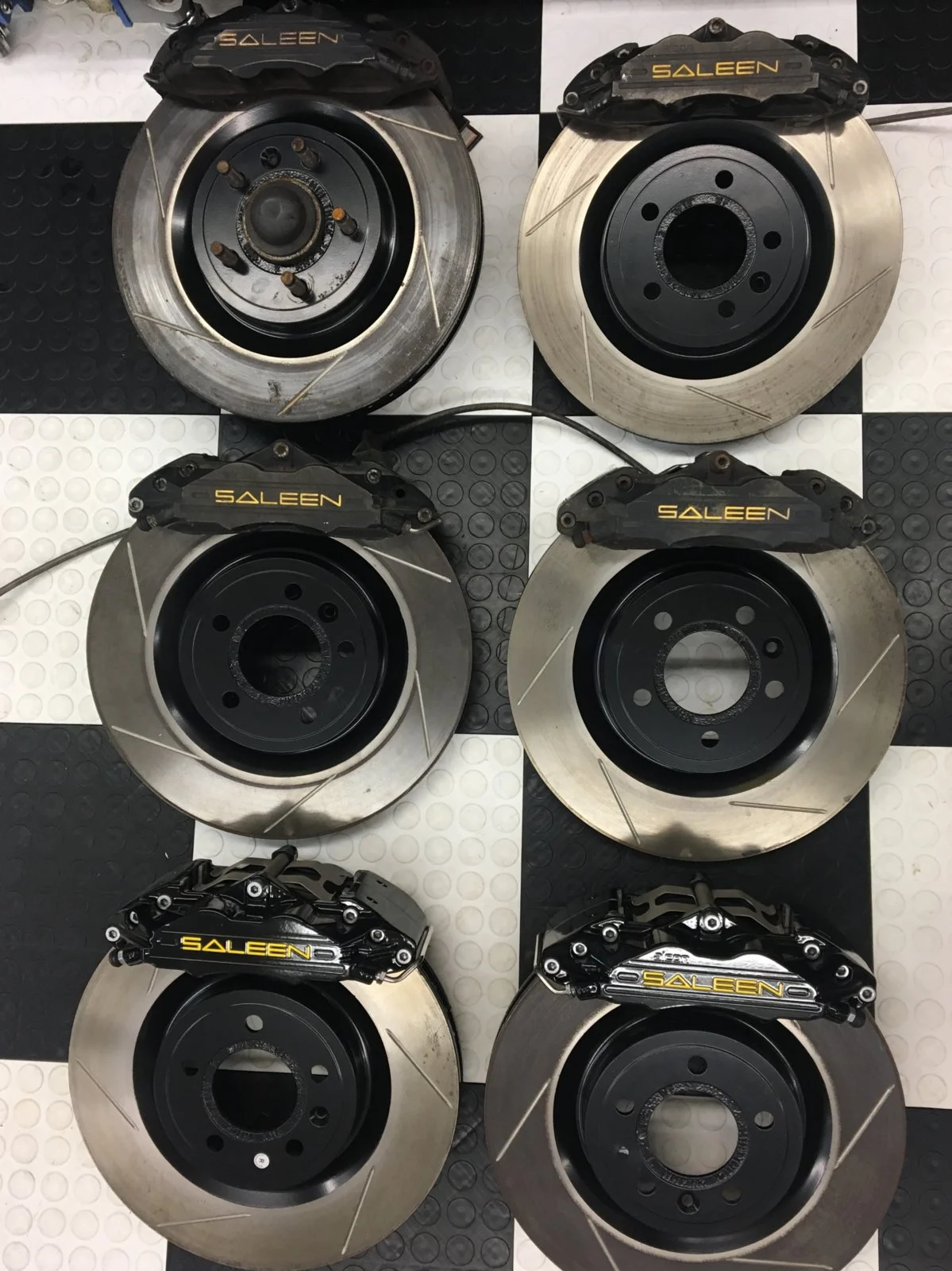

Didn't see the brakes on the sticker (but expanded it was a little blurry), that would be one of the hardest parts to source, i put them back on my xp8 and everyone wants a premium for the alcon Type B's.
Is the paint salvageable?
That's my one automotive fear, paint work (it's not an unfounded thought, I got a price to paint my car the same color for 10g's).
Paint work is my speciality. It’s getting stripped to the metal and completely redone like my other car.
The alcons are in decent shape. They will get a strip, Powdercoat and rebuild. As for the rotors I make reproduction ones in house and will be using those with the refinished Saleen Alcon calipers

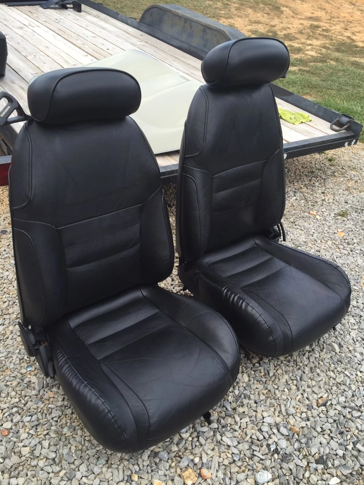

Next up on the project was addressing the seats. This S-351 was optioned with Leather Saleen Recaro seats and a specific head rest.
The rear seat was still intacted with the Saleen recaro design. The fronts however are long gone so that’s what I need to find and then redo the correct upholstery. Someone had removed the originals and replaced them with basic GT leather seats so I yanked these, cleaned them up and redyed them and sold for $250 bucks to put back into the project
