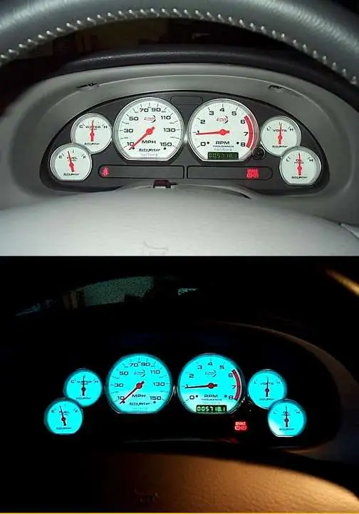

there are two screws right under the top lip of the dashboard. Use the first picture for reference. disregard the night picture!:
remove those and just with your hand remove the bezel. this will expose the screws holding in the cluster itself. unscrew them and youre pretty much set from there
i dont remember anythign too difficult. should take no more than 5 min to take out
