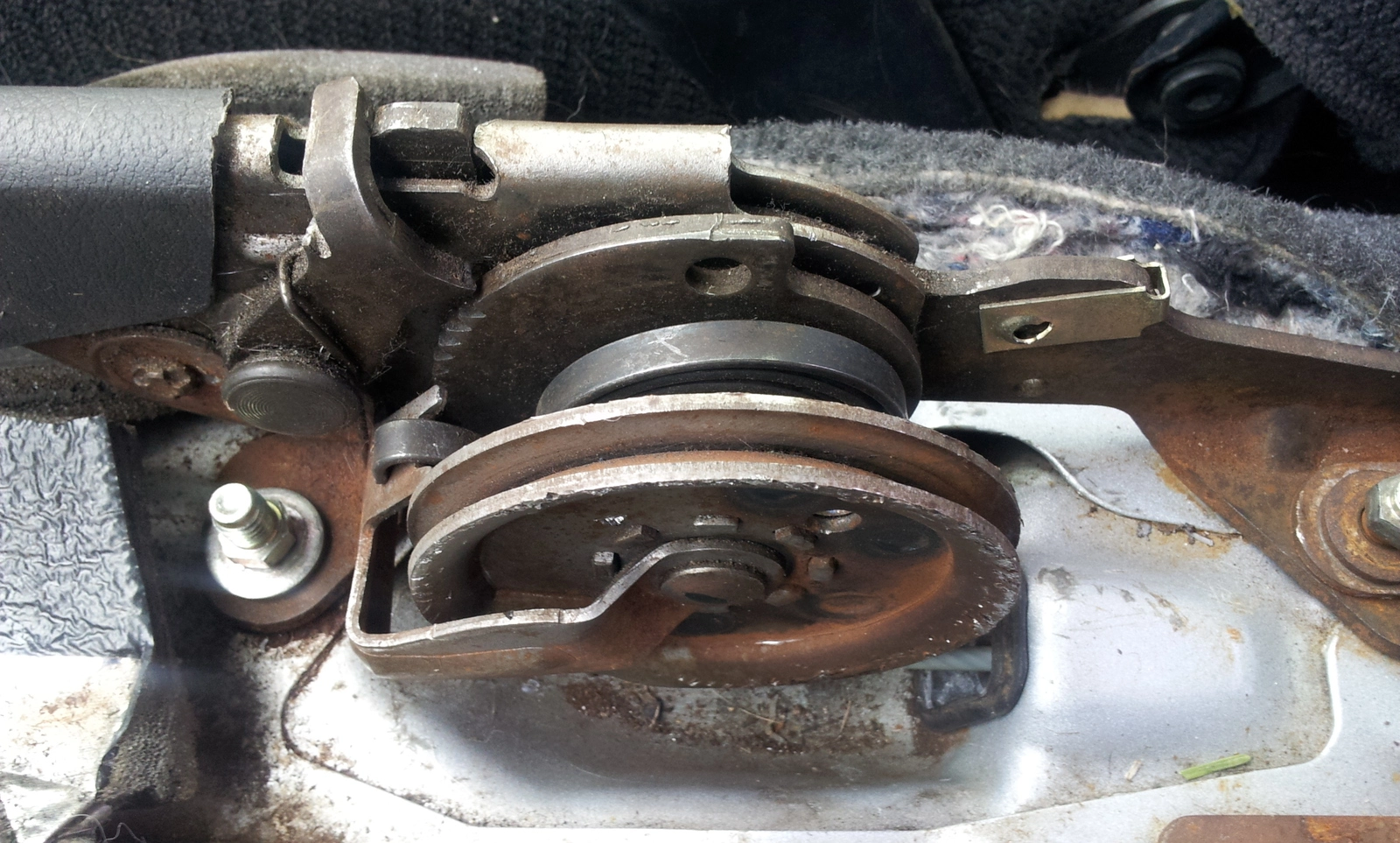

So as an update, the problem has evolved..... I've replaced the three cables and everything definitely appears tighter: To a fault. If you reference the attached picture, the handbrake cannot grab even the highest tooth connected to the spring, so it does not apply the brakes when the lever is pulled. I have checked the tension of the spring, the issue is unchanged. The question NOW is why it's not contacting the teeth, thereby applying brake pressure? I have verified the correct cables were installed and routed the same as the previous OEM cables

It's been some time since i've messed with a handbrake on these cars, but that toothed portion is the self-adjustment portion of the handbrake that is designed to take up slack when the cable stretches.
If i recall, it's spposed to be holding on a tooth on the bottom, not slipped to the top like yours is. Are you able to move that toothed portion at all to "rachet" the holding tooth down to the 2nd or 3rd tooth from the bottom?

Turning the wheel CCW would bring the teeth around, but would release most or all of the tension on the spring as well. Alternatively if I could get just a few degrees more CW, then it would position the teeth where they would be grabbed by the pin on the handle. I'm going to check with LMR about the front cable I bought and verify they shipped the right one. Supposing they sent a 1998 cable, it could be shorter and thus put the teeth out of alignment. Having a longer cable would accomplish the CW rotation and align the pin to the teeth.
There is an adjustable cable as well. With Fox mustangs this cable is used with the self-adjuster defeated and the adjustment is made on the cable end as well.

This one is resolved, everyone. I cut another notch into my handbrake so the pin could catch. Interestingly after the first pull of the handle, it was back to catching on the original Ford pins.
As for the car on the hills, I have not tested it but going by feeling, it begins to really lock into place on the third "Click" of the release. It feels as though it has more pull on the cables than it used to.
