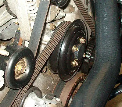

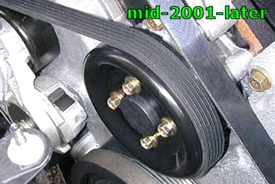

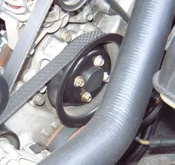

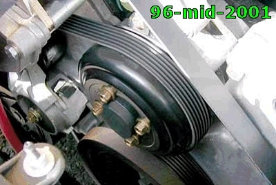

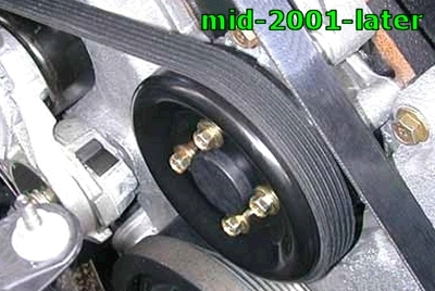

Kilgore Trout said:
This is the latest design, sounds like you got a new water pump at some point:
close, but no cigar. It has the lip like that but the hub is recessed like the second photo showing "mid-2001 and later"???:shrug:

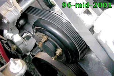

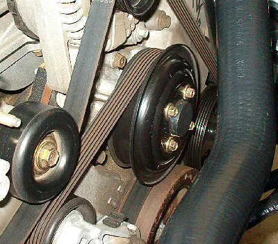

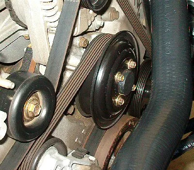

Kilgore Trout said:
Sounds like you do not have a stock water pump pulley then :shrug:
I bought the car in 4/05 and it only had 15k on it and bone stock. It was a leased vehicle in its prior life and never driven. I can't imagine that they would change the pulley???
SLY GT said:
It has the Ford logo on it and numbers.
That's a nice puley, no way is the belt going to slip off that when splashed with water :flag:
02-05-04
Engine 4.6L Front end accessory drive (Fead) belt slips off water pump pulley when splashed with water: Verify condition. Replace the water pump pulley and/or tensioner assembly as necessary. Refer to the TSB for details.
