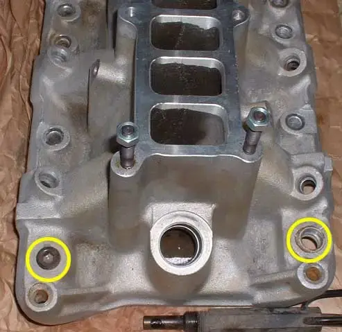

Yes. You will need to either drill and tap the oil pressure extension that screws into the block on the driver side just behind the timing chain cover or buy one already done. Will look something like this:
For the stock temperature gauge you can utilize the port in the rear of the lower intake.
Install the aftermarket gauge sendor in the front hole the stock sender came out of. This is just from several years of people installing the aftermarket one in one of the rear holes only to find out it reads lower than the front holes and is slower to react than the stock gauge. Swapping them around keeps the stock unit working (albeit not super accurate but it wasn't before so no harm no foul) and puts the aftermarket one where it is more accurate so it is of more use to you.

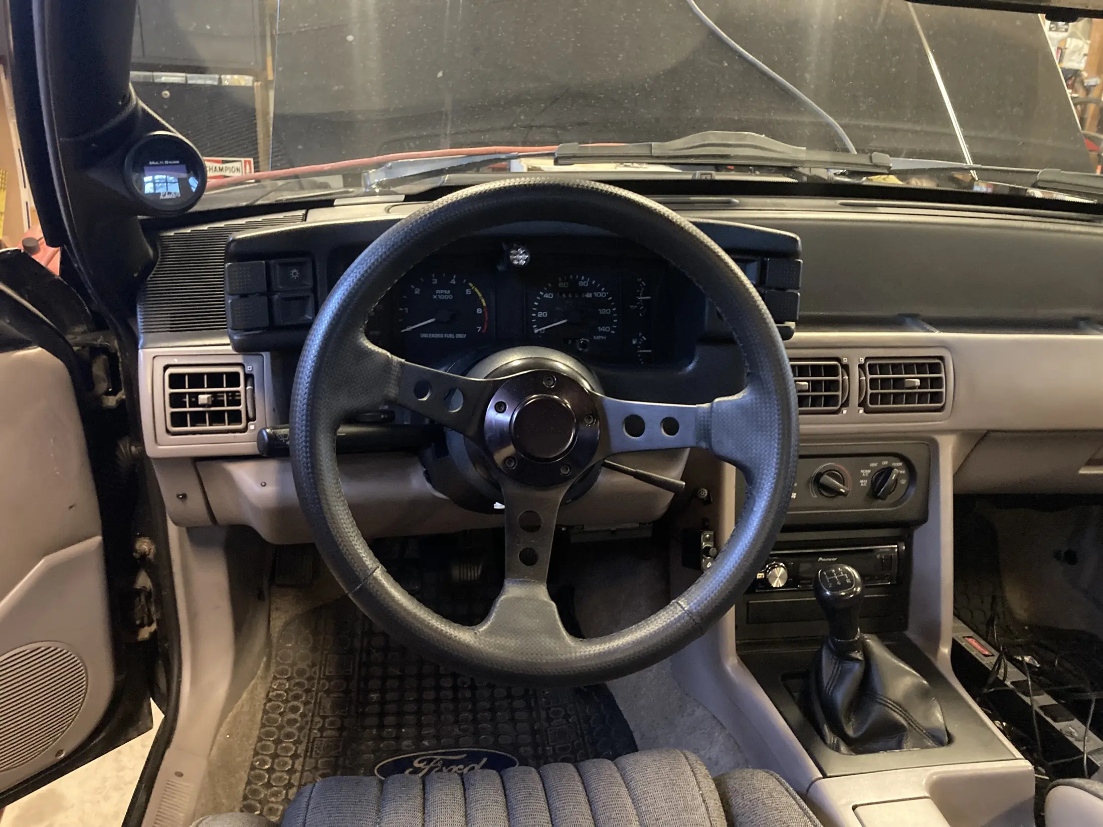

All the factory gauges are still functioning in the cluster. I have a mini shift light under the cluster bezel. Single PLX on the pillar currently with two modules. Wideband and Vacuum / Boost.

Forgot to add pic to last post
