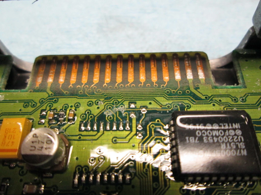

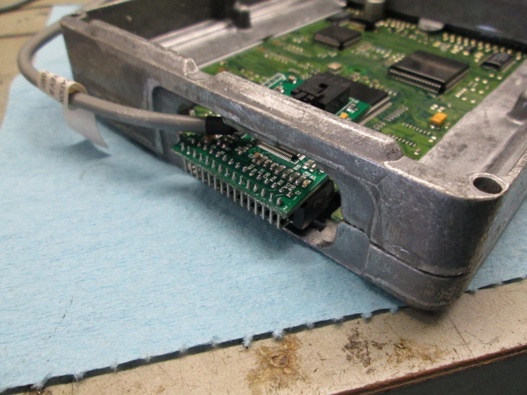

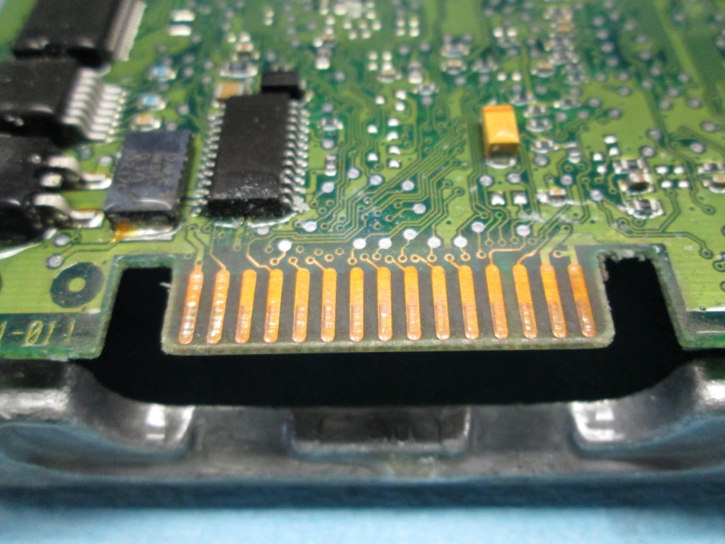

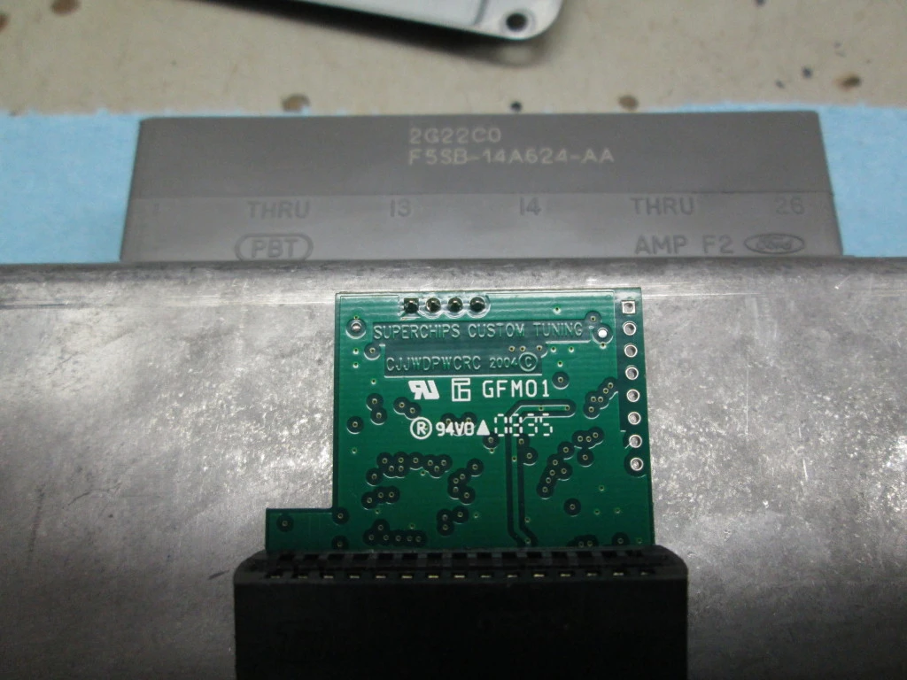

I pulled the ecu yesterday and took a look at it.
I don't like the look of the gold fingers at all. I am thinking when I reseated the ECU and bolted it down that the bracket pushed on the chip which made the problem worse. I got my X4 in yesterday also and was letting it idle to warm up. I was data logging at the same time, about 10 minutes in the car died, I went over looked and saw the X4 said there was an error connecting to the ECU. I also noted when I pulled the ECU, the chip was secured with duct tape, once I pulled the tape it wiggled very easily on the gold fingers, even with the tape I could move the chip a bit.

So I have test run the car in the garage a couple more times. I set the ECU on the floor of the car with the chip plugged in where it doen't contact anything, and it didn't die like it was before. I think it is the chip that is causing me problems.
