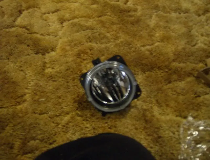

just converted mine...some advice..
-dont forget the mounting brackets for the fogs lamps
-dont get aftermarket fogs( at first i bought them non-OEM, and had to return them and go with ford, bc og=f the TERRIBLE fitment)
you wont really need a wiring adapter, just use a dremel to sand off this one plastic piece(youll see what im talking about) and youll be fine.

I needed no mounting brakets. I used non oem lights that were made just like the oem and they fit great. Wiring pig tails are cheap. I bought my bumper pre painted from pershing auto on ebay. the lights bezels and pigtails from from www.50resto.com, and the chin spoiler from randy at mod depot.
