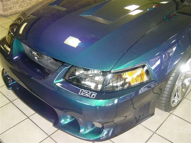

Below is a pic of the saleen bumper used with a 03 cobra hood. The 99+ gt bumpers come up just as high as the saleen bumper, so you will notice a 1"+/- gap between the hood and the bumper.

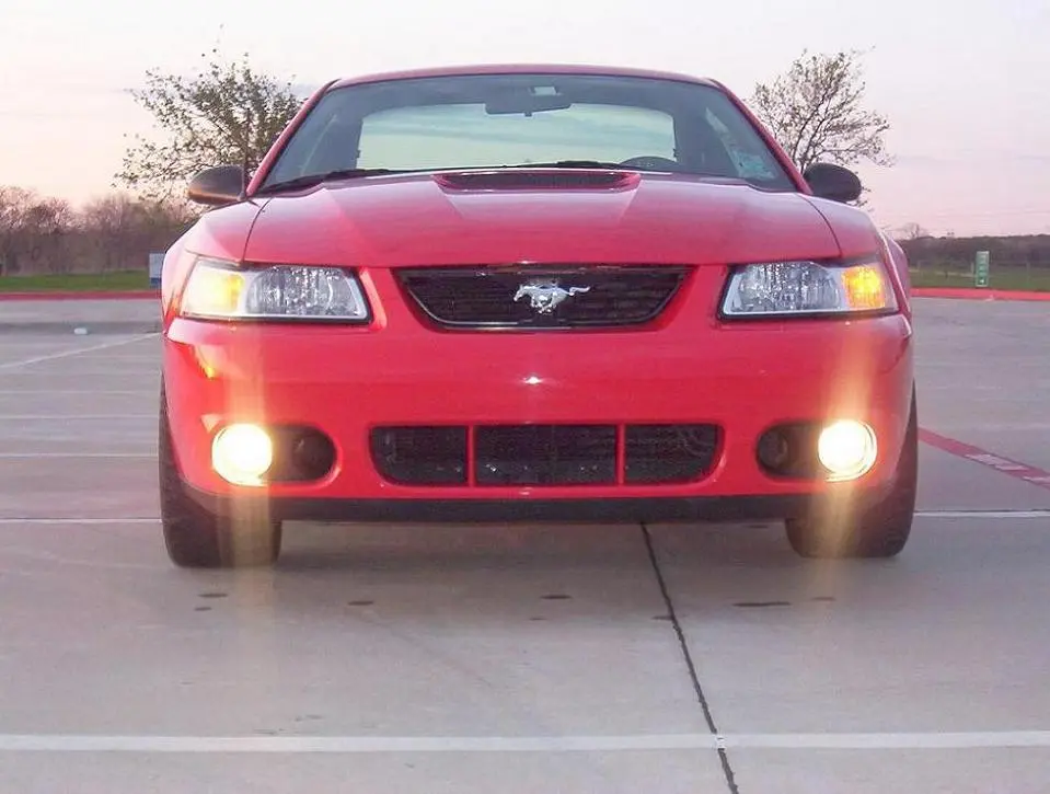

It will fit fine. :D With an 03 Cobra bumper and a stock fitting hood the fit will actually be tight. The fix is to move the mounting holes for the bumper back on the car about 1/4". I did not do this and there is a slight rub, but it cannot be seen, but there is no gap either.
Also, some rewiring of the foglights is needed, but is pretty simple. The other thing I did was paint the core support black as the red was too visible, and I also added a small mesh screen to the opening to help protect the raditor/AC.
