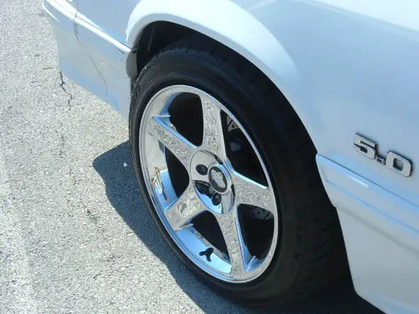

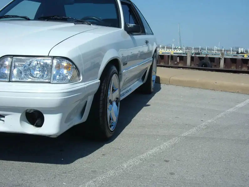

Also, I would like to put some 275/40/17's on the front. Now with the 245/45/17's on the front they don't rub but on a very rare occasion. The problem is they don't look good on such a wide wheel. Anyone think it would cause a problem running that tire up front?
There's some pics to show what I'm talking about with the front tires.

Hmm, I think I would put my back tires on the front before I went ahead and bought new tires all the way around. I would drive with the 275's up front and the 245's out back ( goofy looking ) for a day or two to see how it works out.
