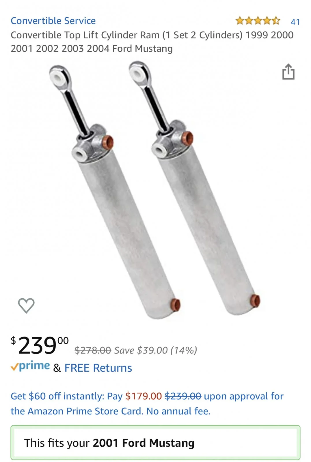

My side lifter went bad. After it was replaced, the top raised and lowered normally.
I don’t remember if the top made noises when I tried to operate the top.
The main motor could be bad.
My car is nearly 20 years old. Looks like a pretty straight forward job to replace.
