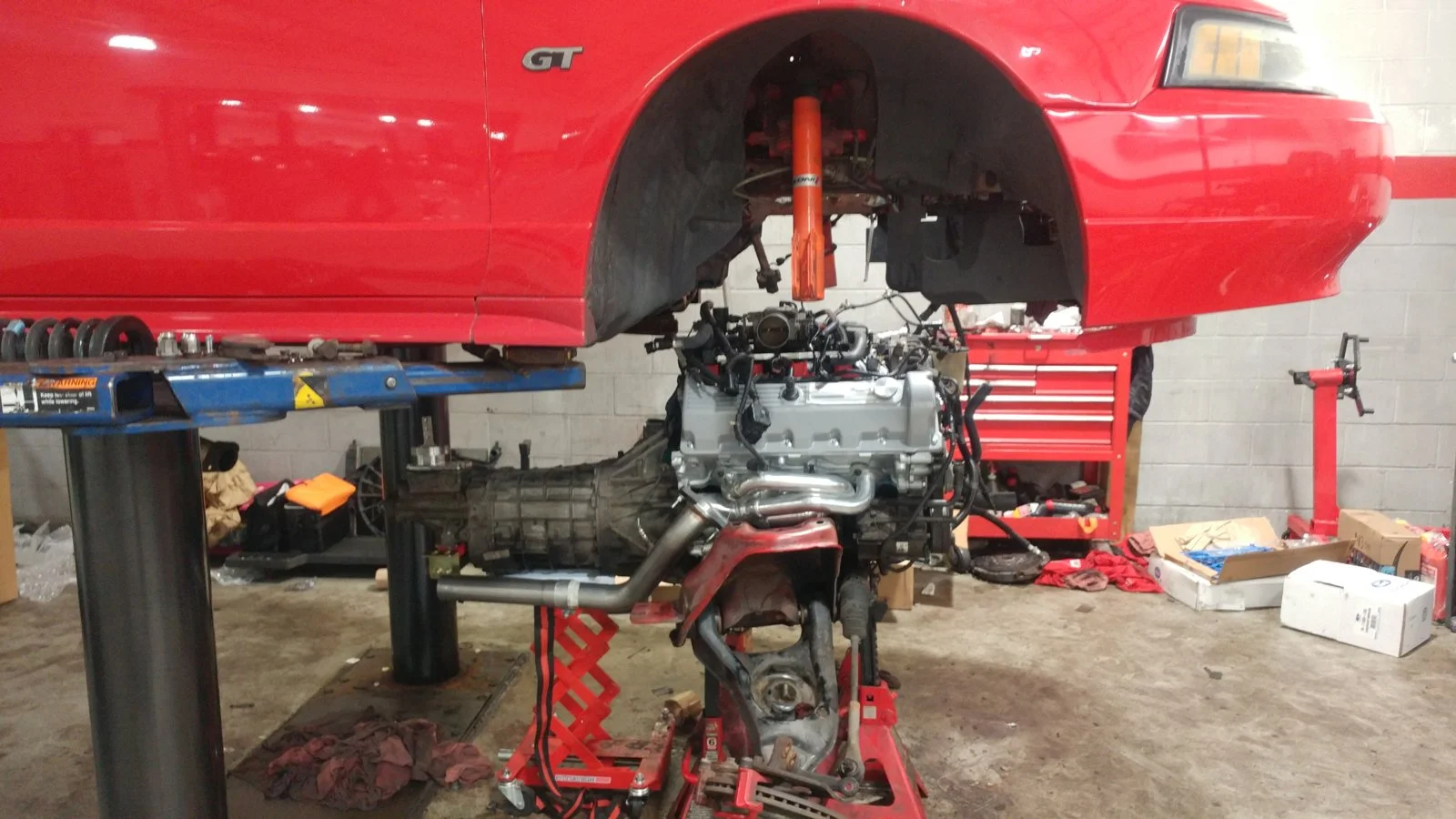

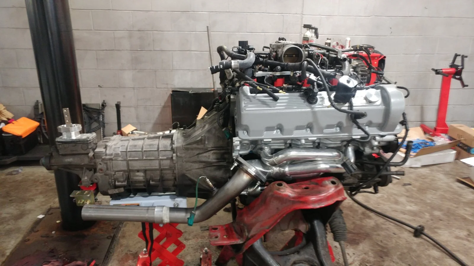

Hey bud,just saw this..i ran into that problem the first time i replaced my intake. I just cleaned the surfaces up and used a thin layer of rtv to fill the pits. That was many yrs ago at abt 100k. Lasted until i replaced the longblock last year at 266k..i also plan on going 2.1 in the spring..cant wait! Ive got 11k on the new engine now so its broken in and its time!!
I may actually have a pic of when i took the intake off the old longblock to retain the bolts...ill check.
Gahh...i only have pics of the old block with the manifold still on it..

Haha, i know all too well abt military,deployments and deployment bankroll...lol..my son was in the Marines and came back from his first deployment to Afghanistan with way too much money in his acct...lol. Didnt take long for gim to find his dream car, 2002 BMW M3..doesnt end there but i wont bore you with all the details haha. So im actually in the middle of a rolling resto of my 02.. Its a daily driver still(had it since day 1)and i just started the resto 2 yrs ago by completely replacing and upgrading the suspension..ff to almost a year ago at 265,700k i replaced the long block and upgraded a buncha stuff at that time too..currently waiting to get car to body shop to repair the passenger quarter panel that was damaged in a fender bender a few yrs back and is rusting out pretty bad rt now. Once spring breaks ill be finally throwin the KB on it!! Engine is broken in nicely now. Ive got abt 11k on it(277k on the car) and its running great! Spring cant get here fast enough!!
Aullutz, man I didn't see the pics you posted yesterday. Looks good!
Haha...thanks...that last pic is from 50 ft away and car was wet..lol...cant wait to get it to body shop for the quarter panel. After that im replacing both fenders and putting a Terminator hood on it..not sure if ill go terminator bumper yet. So excited to get to spring and install the KB!!
