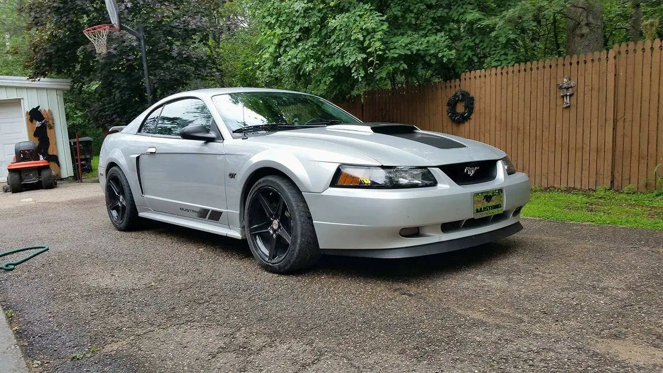

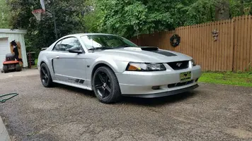

received_1599956643383082 (1).webp Hello stangnet community, first post, first Stang, first clutch job.
Bought my 03 gt 113k, throwout bearing is doing some rattling (I hope that's all it is,) have an excedy stage 2 clutch kit ready to put in.
My main purpose is just for help and recommendations of what can make my life easier. Ie, tricks for easier removal/install, tools needed, and what other parts should I swap out while the trans is out? I've heard synchros go out, gears that give the speedo readings, rear main? Etc.
Thank you!
