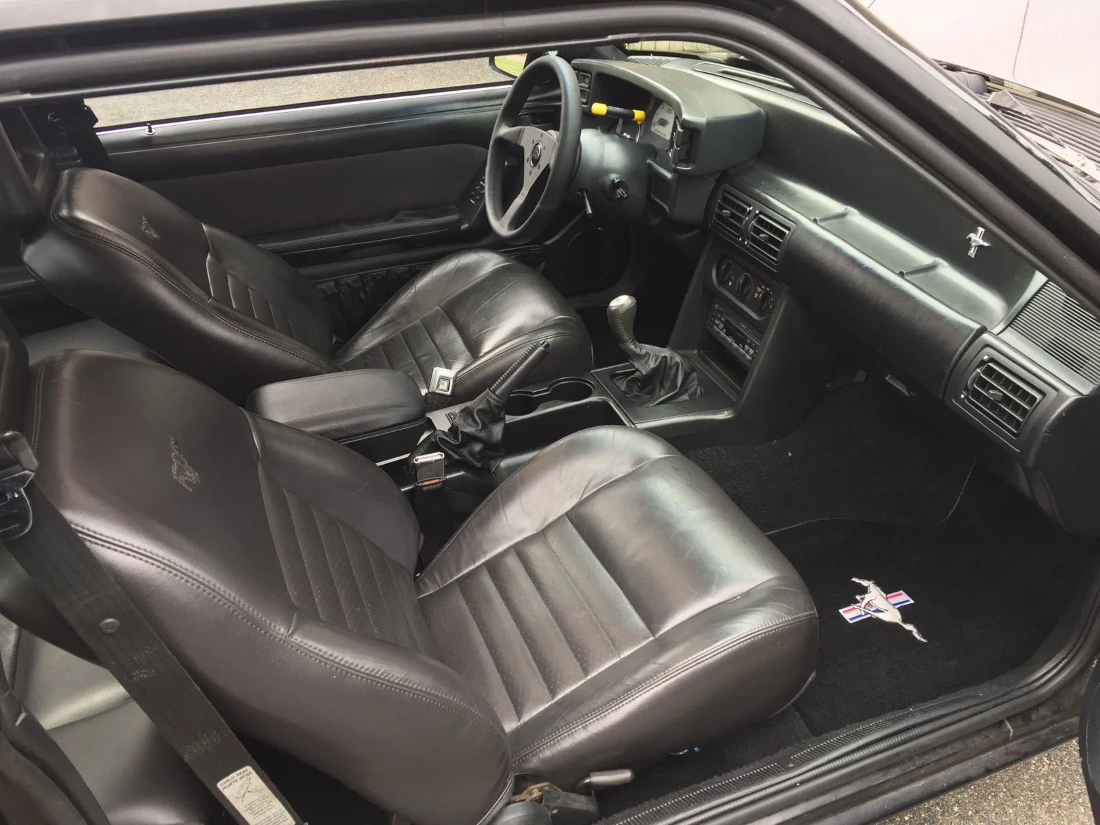

Front seats just bolt in, tracks and all. Just need to create a wiring harness to connect to the foxbody power plug under the seat. You can also swap the fox manual tracks on. Driver's seat will need a couple spacers if you do that.
If your car is a hatchback, the rear seat will also work with some mods.
These are 99-04 seats I used to have in my car
i didnt know the back seats work too..... thats awesoe... where did you those halo head rests?
Backs fit, but what you are really doing ha taking the seat covering from an sn95 coupe and installing it over the fox seat frame. Really easy to do and comes out clean.
The halos are 84-86 halos. They fit just like they would in a fox seat
