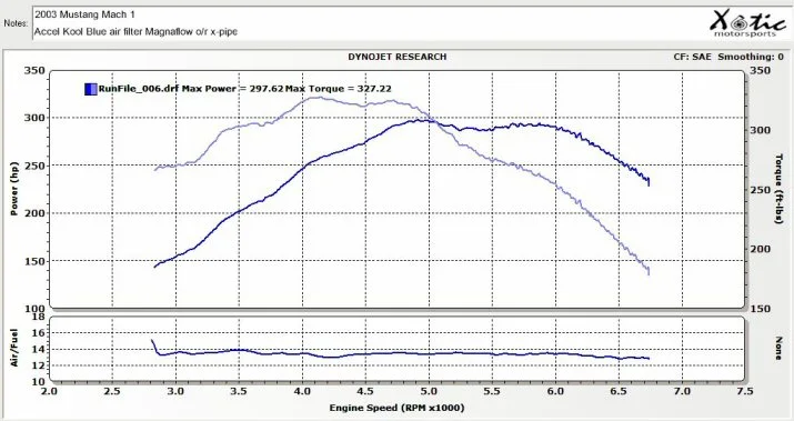

Well I can tell you from my experience, yeah, it's gonna be loud, real loud! I'm running a Magnaflow o/r x-pipe through the stock catback, and my neighbors hate my guts! On the dyno, this one change increased rwhp by 10hp and rwtq by 12.5tq, so don't believe that old wives tale about losing torque. It took over 1,000 miles, but my "service engine soon" light finally came on. I just installed the plug-in MIL eliminators from Dallas Mustang, and they seem to be doing the job.
