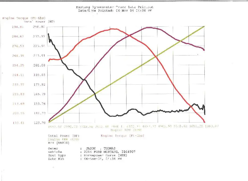

Took the 04 to the dyno today was very happy with it.
It was a Mustang dyno and I did very little tuning my predator was allmost right on.
Pulled
248 hp @ 4750 rpm
292 tq @ 4000 rpm

h pipe, flows, CAI and predator = 248 hp on a MUSTANG DYNO??
isn't that like 260+ on a DynoJet?
i think there's something wrong
looking at the graph i am very confused. why does one of the lines drop OFF the map??? neither HP or TQ should do that??
what did he enter as the weight of the vehicle?
The a/f line drops of the map and the tq drops off casue I took it to shutoff and it kinda spikes the graph. He put the weight at 3750. Yeah seemed kinda high for a mustang dyno but all dyno are differnet so who knows.

Stock GT's dyno ~ 215rwhp on Mustang Dyno's... so that means you got 30+rwhp from mods that don't equal 30 Mustang Dyno rwhp...
Just my observation...
and I don't think TQ should ever drop off the map like that...

I do agree about the hp/tq dropping off. :shrug: Something is weird.

3750 seems high and probably accounts for the numbers. Would be lower if the weight was lower.
Dyno's vary so much from place to place even with Dynojet's, it's best to use the same dyno for tuning. Hard to compare numbers on different dyno's.

Yeah it's 260 at the flywheel not the tires. Who knows this dyno supposed have a good rep. But yep all dyno's are different and it vary this is probaly just a high reading mustang dyno.
What's a fully loaded gt weight ? And am about 150 I thought 3750 was pretty close.
Oh and as far as going off the chart I didn't think 150 ft of tq at 6050 was bad ?

I think the v8 coupe is 3250 + fluids + driver. So your 250 or so high.

The HP and torque numbers aren't lined up. Look at the left side of the graph closer. I think if the numbers matched up for both they would cross at 5250.
That number is a bit high, but it doesn't really matter what you dyno, the only nubmer that should be in your sig is what you run in the 1/4...:)
