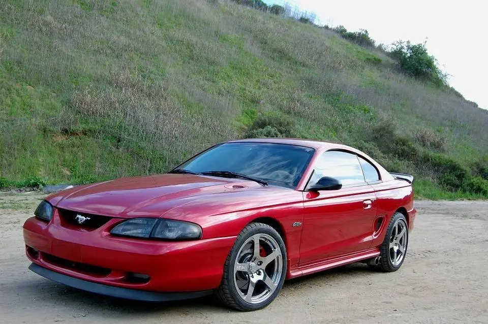

My car with 18x10 wheels that were made for 05+
It took cutting down the front 1" and a 1" spacer in the back. Both a spacer and cutting effectively lessen the backspacing, which is what you need. I needed to cut due to 10" front being huge, my guess is you just need spacers.
