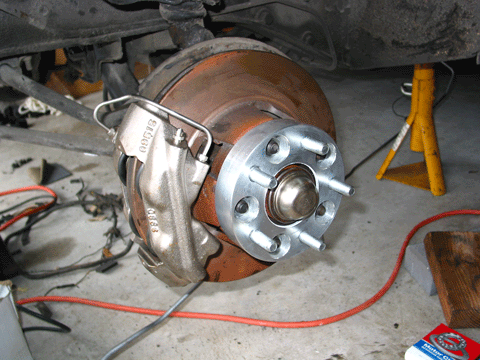

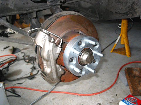

It might sound trivial but there's a difference between wheel pacers and wheel adpaters. The former are kind of risky for a performance application and even then only safe out to 3/16th or so and may require new lugs. Adapters are safe out to 1.5 inches, and some argue up to 2 inches.
Spacers are like washers, adapters have a new set of lugs. You bolt the adapters on like a wheel then bolt the wheel onto the adapter. The ones in this picture are 1.25 inches and are to allow a set of 2001 Bullets (17X8) to fit correctly on my '67.

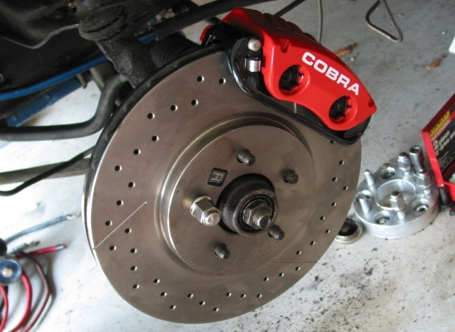

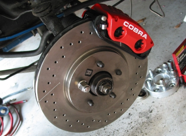

By the way, I dumped those factory 10" discs for these 13" Cobras recently (you can see the adapter on the floor in the picture too):
