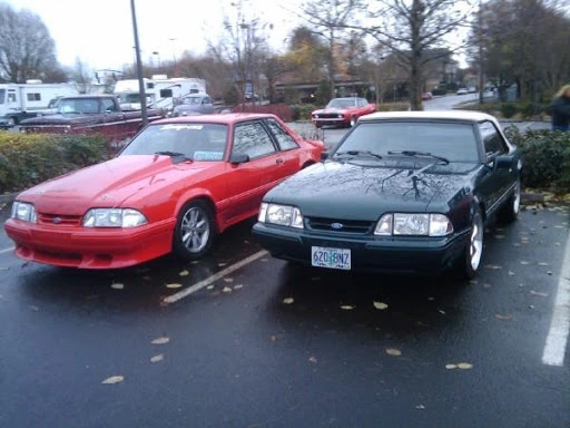

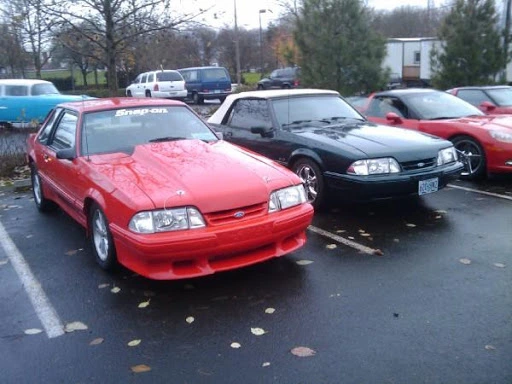

My 91 (the red one) has 05 GT wheels and 94-95 spindles with 1/4" spacers. They're pretty narrow and they rub on the lower A arms at full lock. I just haven't changed the spindles out yet for 96+. The rears are SN95 axles.
Repo style...Your the man!:nice: I just picked up a 96 saleen pbr set up for both fronts for $150!:D I see these wheels all the time, and I like them, but did not know what they looked like on the fox! Quick question? with the 96 spindles, would I have to run spacers on the rear axles??? How large if so?:shrug:

It's the offset of 05 wheels on the 94-95 spindles. I can put 94-95 wheels on there and it would look fine. As far as the rear I'm using the longer sn95 axles with no spacers. Just use 96+ spindles on the front and you'll be golden.
