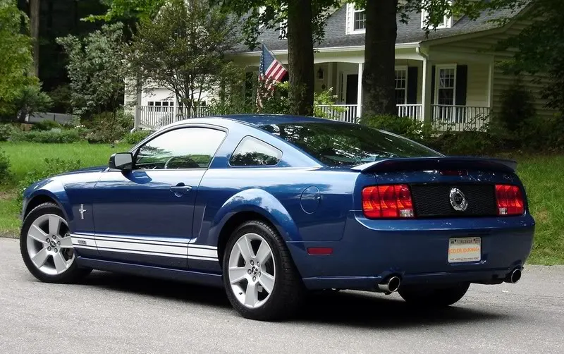

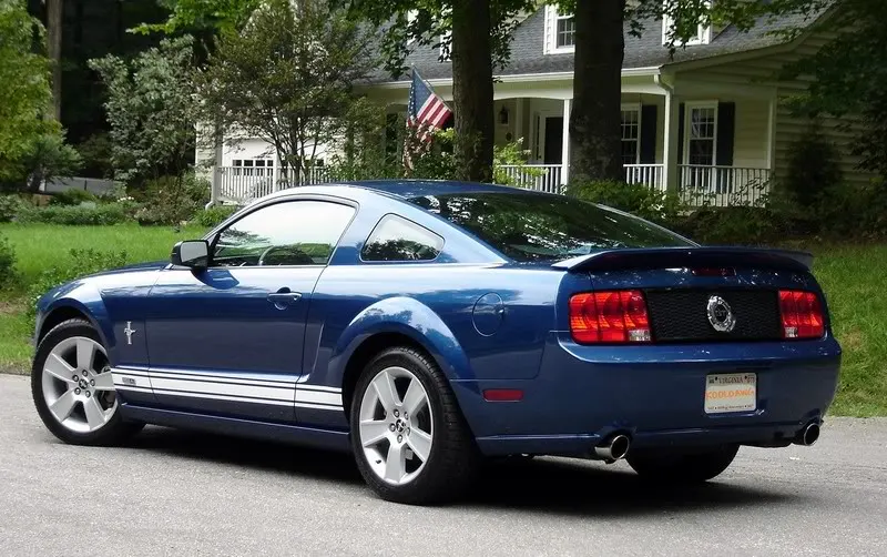

An appearance mod I would do is the honeycomb rear panel from Silver Horse Racing.
Why would you suggest such a thing:shrug: :shrug:
:D :D :D
