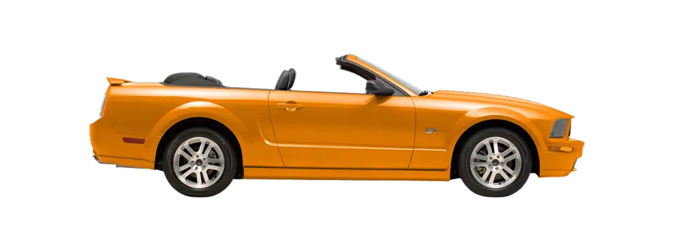

here is a picture from tirerack:
And this is what I was talking about in my first post......

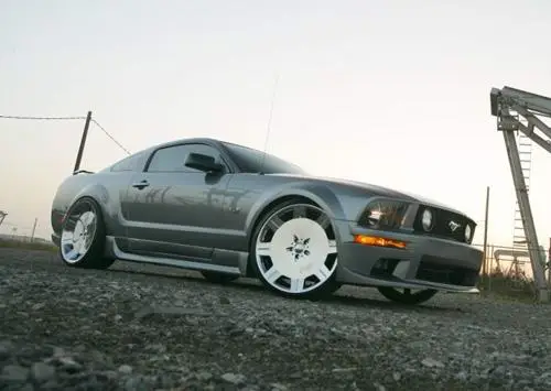

and this picture:

That White Mustang looks RIDICULOUS :notnice: . How come the Mustang in the Tirerack add in this month's 5.0 look's amazing with 22's and that one looks awful? I am just trying to figure it out because if all 22's are going to look like that I better rethink this..
It's funny. I've seen more and more mustangs with 22's that don't really look that great.
