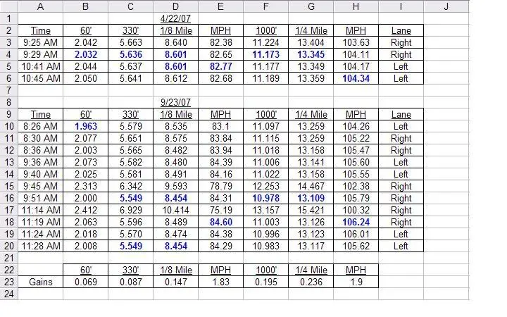

No video from late summer runs, but here is the chart I made of all my runs. You can notice the gains I made at the top end of the track after the weight reduction(190ish lbs), but how it hurt me off the line.

Yeah, there's not much more left in the 60' with street tires, but there's plenty left with the tune. Ford's tunes are conservative at best. They still leave plenty of throttle lag and sloppy shifts. Get a good tune from Brenspeed or Bamachips and he'll see 13's no problem.

Hrm... I thought the 06 was weighing in more than that.. oh well. It's still a difference. Stock for stock, you would think they're quicker, but the S197 platform is drive-by-wire. That makes a HUGE difference. Without a proper tune, throttle lag and shift firmness is terrible.
Before the tune, my '06 auto was very sluggish off the line and shifted really smooth. So I can see how the stock auto would be slow comparatively. I never baselined my car before the tune, but the SOTP feel was night and day(that was before CAI/gears/H Pipe even)! In my spreadsheet below, the first 4 runs were at full weight, so I know a custom tune alone will put these cars in the mid 13s(weather/track prep permitting). Spend the money on tunes either from Brenspeed or Bamachhips and you won't be dissapointed.
