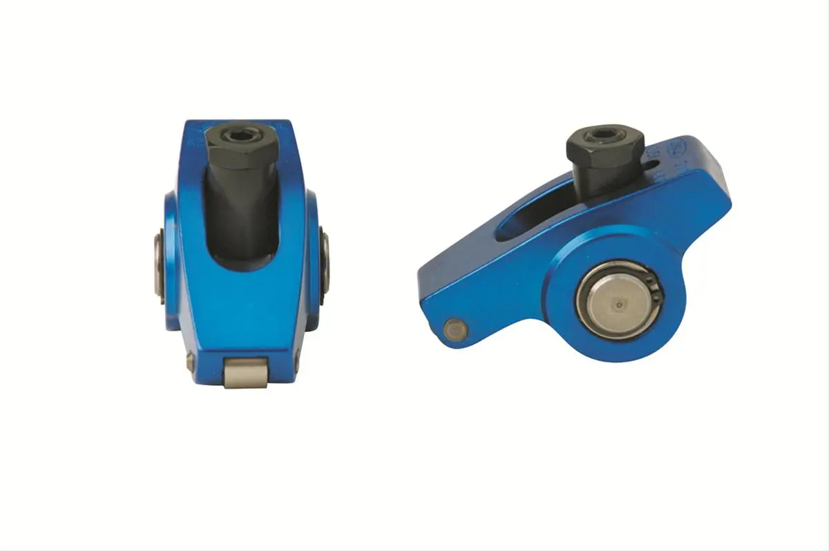

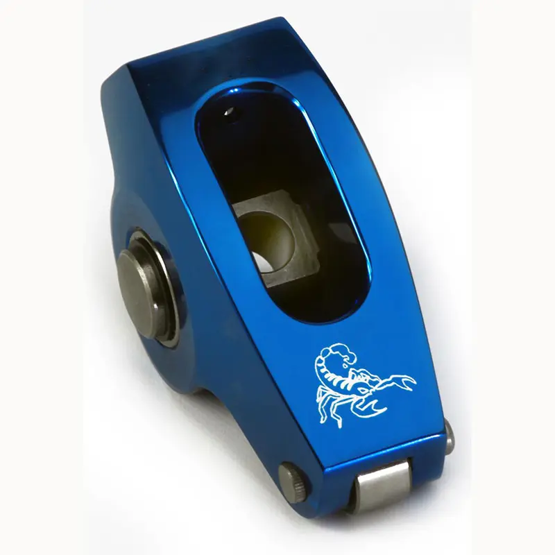

I have a set of Scorpion 1.6 RRs that will not fit under the stock cover and a set of FMS 1.7s that do.
You can kind of see how the Scorpions in this image are just a bit "beefier" when compared to FMS RRs.
