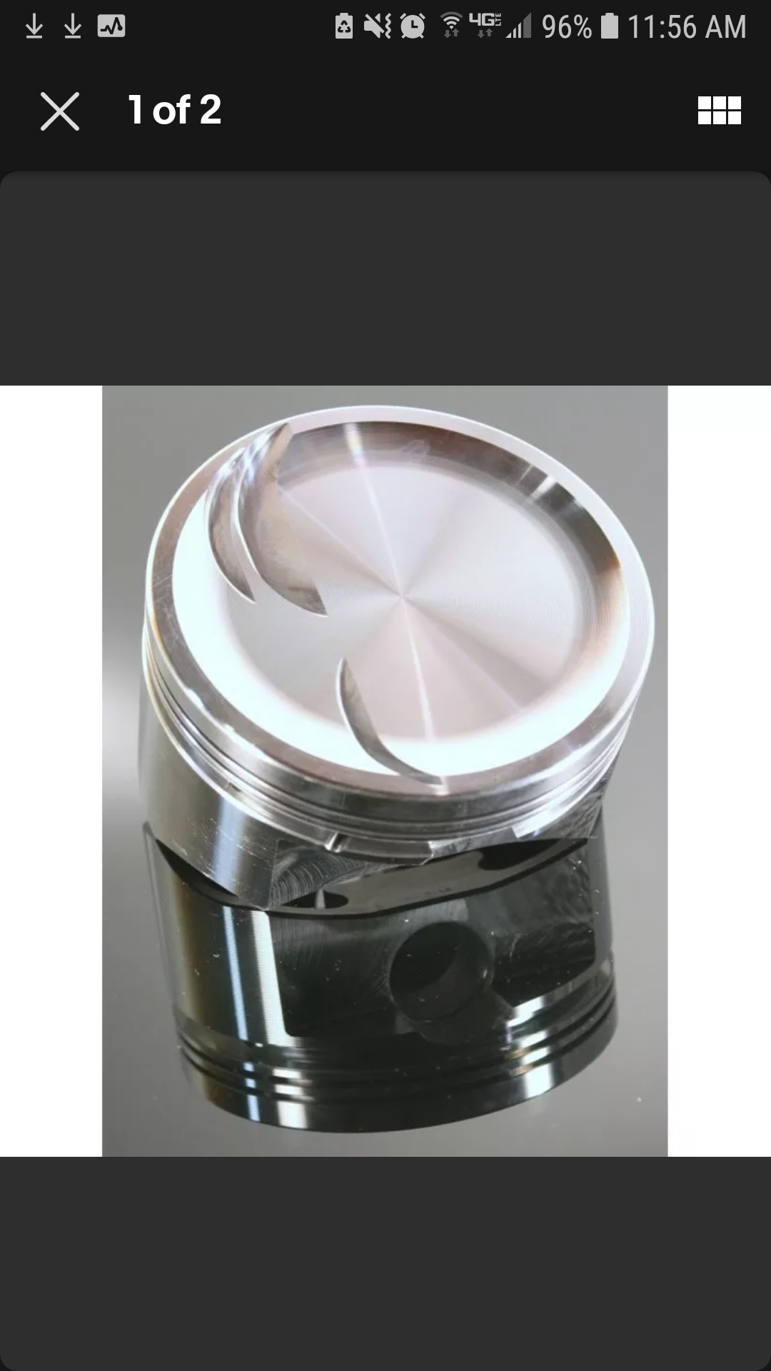

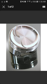

Prob unlikely you will just need some more radial. Here is a dual pocket piston you can see how different the two locations are.
