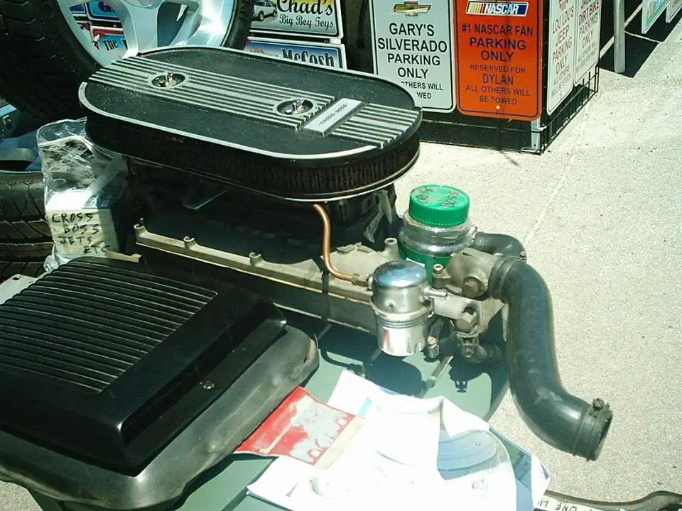

Check this one out! If I remember right, I think the guy was asking somewhere in the neighborhood of around 4k for this Cross Boss I found at Tulsa a couple of years ago.

Cross Bosses, Mini-Plenums, original individual-runner manifolds, and other rare race pieces...yeah, they can sell for quite a bit.
