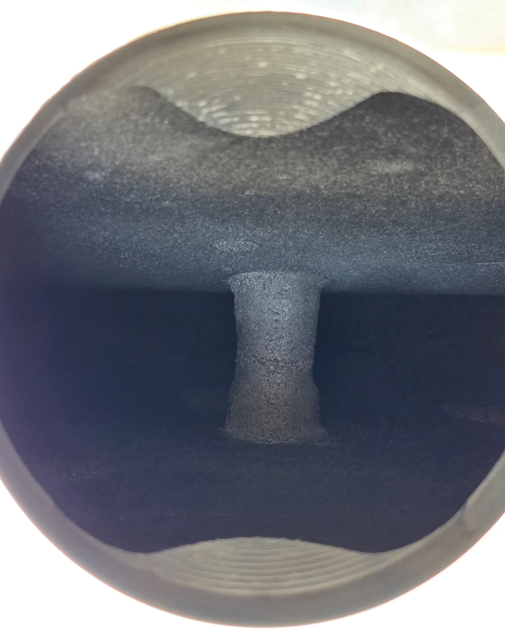

Dropped the Trick Flow Series R intake off at Extrude Hone AFM on Monday. Cost, including a 10% military discount, was $671.29. Here is a before shot looking down the throttle body opening of the 90mm intake.
Here's a Super Ford article on the Extrude Hone process from October, 1996.
Super-Ford-Magazine-1996.pdf https://share.google/PRZkMmRge7k9epXyJ

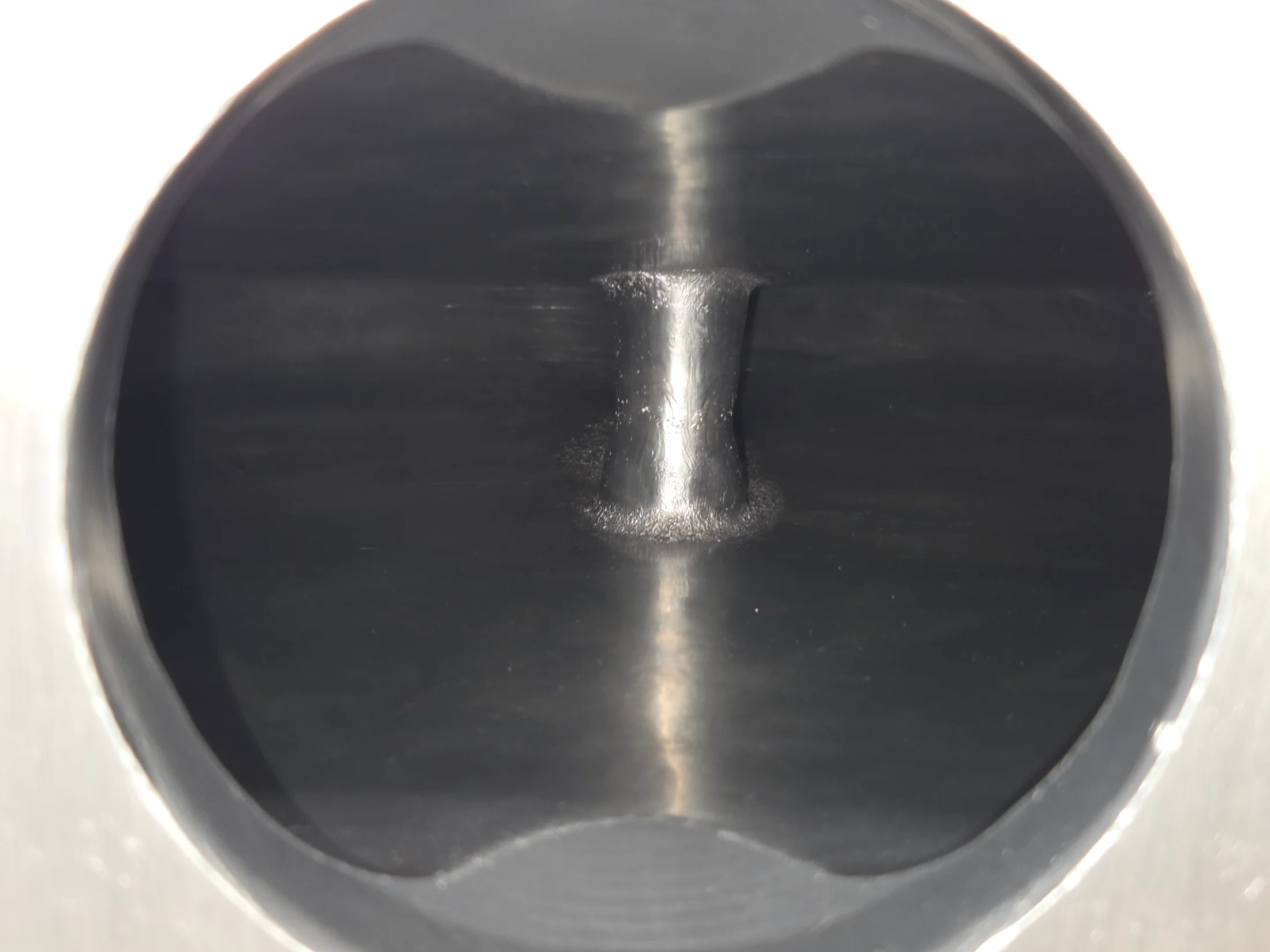

Got the intake back from Extrude Hone AFM. Interior of the intake is significantly smoother and the ports are clearly larger - see attached photo. A fairly large portion of abrasive material was left in the center runner, and it took quite of bit of time and effort to remove and flush it out using solvent. The front and rear freeze plugs weren't removed by the technician, and had I just called it good and installed the intake it may have turned out catastrophic. I ended up removing the freeze plugs easily with a nail set and hammer. Dyno tune on Friday (3 July), but the butt dyno says not much was gained.

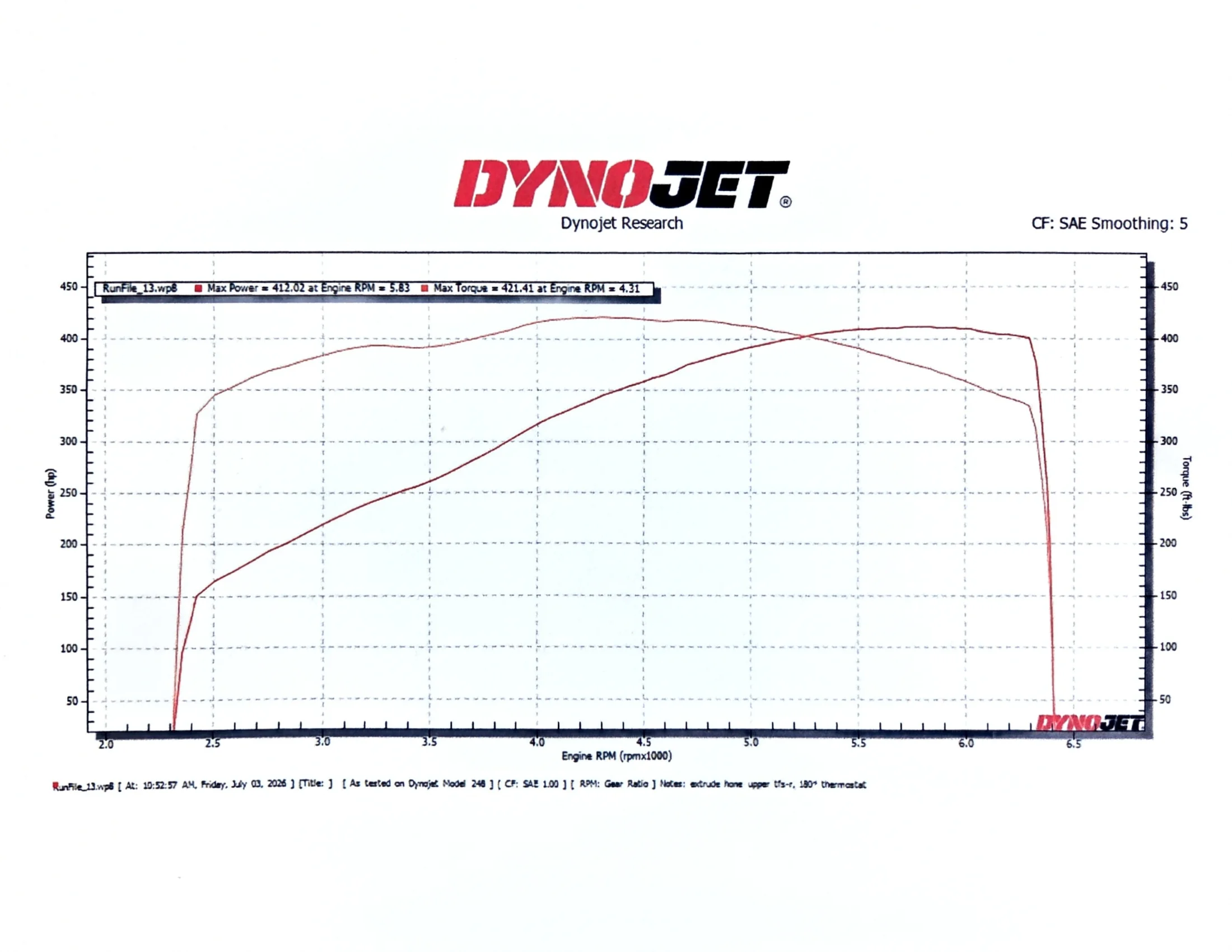

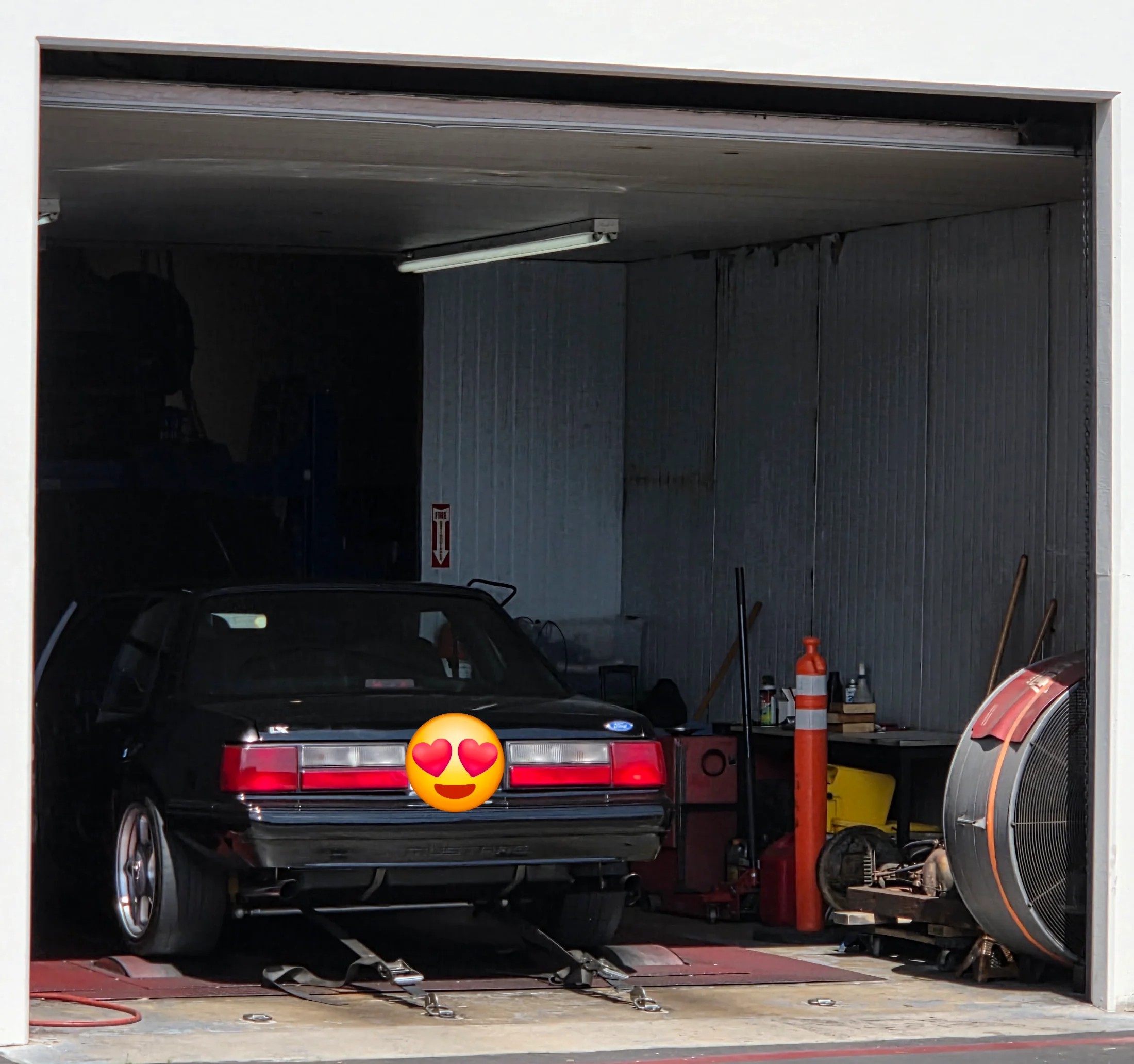

Dyno tune complete. Car picked up 12 hp and 24 tq, 3% and 6% gains respectively, for a total of 412 rwhp and 421 torque. I'm very happy with the overall numbers from the N/A 363.

I am most impressed with that torque curve on an N/A build.
That's pretty amazing.
