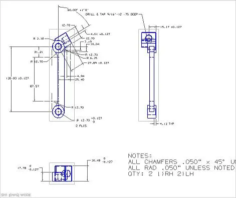

Are there any other options for the brackets other than the $300 Mustang Steve billet aluminum brackets? I'd like to have steel ones. Did anyone ever come up with a cad drawing?
This is another area I'm working on. I've got Cobra discs for my '68's rear, so naturally I have to have Cobra discs on the front.:) --I have '75 Granada spindles on my '68.
Mustang Steve offeres conversion brackets to mount the Cobra front discs to the stock Mustang drum brake spindles, but not for the '75-'80 Granada/Monarch spindles.
With the Granada spindles, I'm not trying to infringe on his "territory".
Will you be able to use them with 15" wheels? Will the brackets be steel? I hate the thought of aluminum trying to keep from ripping the caliper from itself, especially when my family might be aboard. Normal driving, this probably wouldn't be a problem, but if I make a road course excursion, what's to say they won't get work hardened?
bracket
here's a copy of the bracket Baer makes for the 12" Track setup for a Granada spindle. Haven't been able to figure ou the dimesioning shown yet:shrug:
