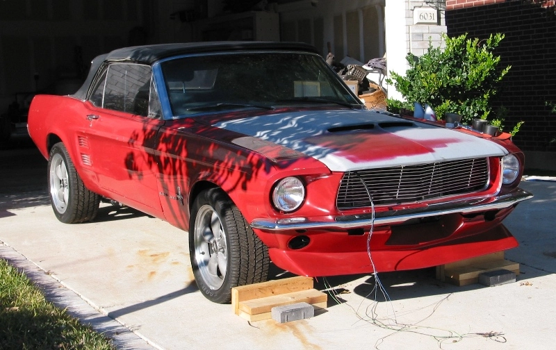

JOB VERY WELL DONE!! congratulations! Hey, those bullit style rims look great on your coupe, do you have any more pictures with them ? (and possibly the fenders on? :D ) So, since I have granada spindles, how hard would it be to find the '66 mustang hubs, do you think?
and I hear you 'bout the Temps here in Texas, as I'm in San Anotnio, I can't wait for winter to roll around the corner either!! :)
It's a convertible. I think it is, either that or my roof is wrinkled...hmmm :D
There are pictures on the website, but here's one with the fenders and hood:
You can see some of the wires hanging out the front in that picture, the wiring is a beyotch for me.
Drum brake parts are much easier to find that disc parts. I got my parts from the classic-classified section right here on Stangnet. I bought the rims off an '01 owner in San Antonio who put 18s on his GT.
