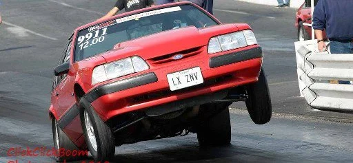

a friend of mines LX... 100% stock T5 has made 100's of passes doing this
T5's usually break from missed shifts. He must shift clean.
....and not power shift 3rd very often.
I'm not making nearly that power but I got a ton of life from my t5 at my power levels and took it out and sold it still working in favor of a tremec upgrade. Shifting proper will get the job done and not break em.....usually
funny thing is it doesnt make a ton of power... its a ford racing crate motor with GT40 X heads and a E cam
+1 on 3rd gear. I've broken so many of them I've lost count.
And 85_SS left out twisting the car up so bad the door won't open or shut because of no cage. Done that, plus the stuff on his list. The fox is a great platform, but If you don't make necessary adjustments to it for making power, the list of broken stuff will get very long...
