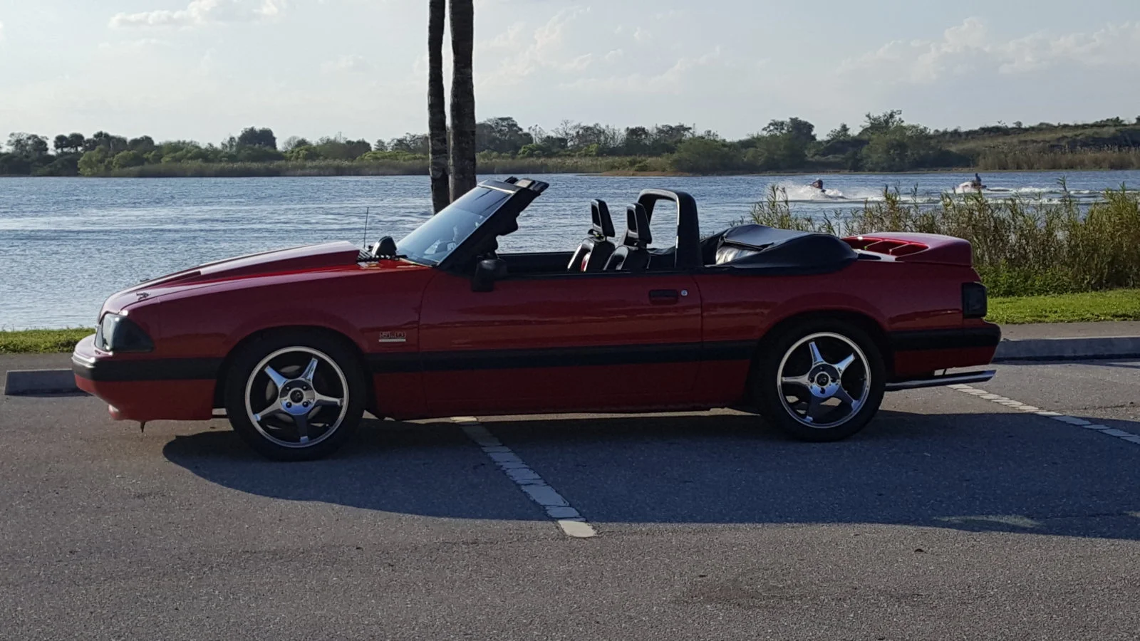

Hey gang,
Been away for several month with work, life and putting back together the 90 convert. Long story short, after 9 months of being at the "buddy's" shop where it sat, was damaged, hacked on, and lies after lies. I finally towed her home in September. I've spent the last months fixing the body and mechanical damage caused by this ******* and also needed the car retuned. ( he stole the chip and had the base timing at 30BTC) I got the panel and hood gaps as best as I can- I am no body man by a long strecth.
These are the items I had to fix and/or installed- mind you all that was needed was to replace the cowl area due to the hood coming up
  • Painted under the hood in the cowl
  • POR15 the frame, inner fenders, cowl, floor
  • Had to retuck all the underhood wiring
  • Had to redo all the ignition wiriing that he had backwards
  • Installed a FOMOC TFI to replace the crappy aftermarket one he put in
  • installed new hood struts as he lost the ones I bought
  • rerouted all the vacuum hoses and brake lines on the cowl
  • removed the wiper motor and installed a Scott Rod polished piece
  • Reinstalled the fuel bpressure boost gauges lines and new Cowl pice
  • New plugs cap rotor
  • Redid vacuum lines as half were broken
  • Replaced TV cable bushing
  • Replaced all windshield weather strip, trim, moldings and windshield that he broke or lost
  • Installed new
  • window tint
  • Replaced front speaker grilles he lost
  • New dyno Tune and SCT chip- he stole my old one 441 RWHP
  • replaced EEC relay that he fried
  • replaced cowl to firewall weatherstrip he lost
  • repainted front bumpers SEM black that were damaged
  • Had to cut and buff entire car as it there was so much trash in the paint.
  • Replaced both hockey stick moldings he broke
  • Replaced driver rear 1/4 window motor that he broke- found a whole bunch of broken glass there which explains why there was a new 1/4 window
  • Replaced the factory tach as he snapped the needle and shaft off- How in the hell did he do that
  • replaced all floor mats as they were stained beyond repair
  • replaced the fan controller that he fried
  • Replaced the rear tail light covers he broke
  • Replaced the rack and pinion with a Cardone one- it was leaking- dont' ask me how he managed to do that
  • Replaced the PS pressure hose he tried to remove and it was leaking
  • Installed a shift light
After 5 months got her done and took her out today for a drive
Glad to be back and hope everyone is well and your projects moving along
Bear with me as I share some pics .

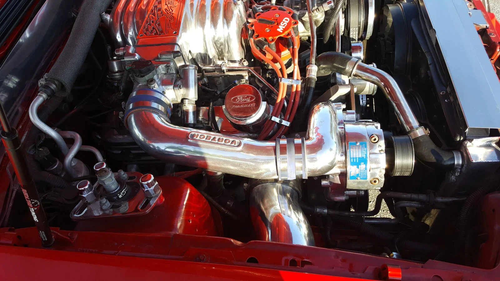

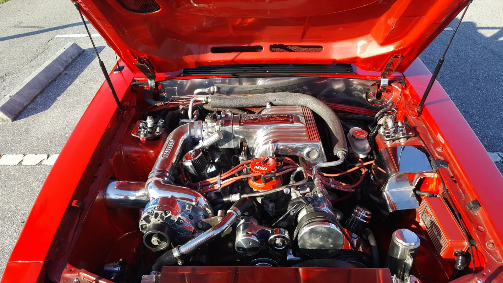

Very nice man, I just deleted my wipers as well and motor and I’m debating on just mounting the old bracket back for now or buying a 12x12 sheet of aluminum or something, trace and cut the piece and mount it so it’s sealed off. Is that a V3?

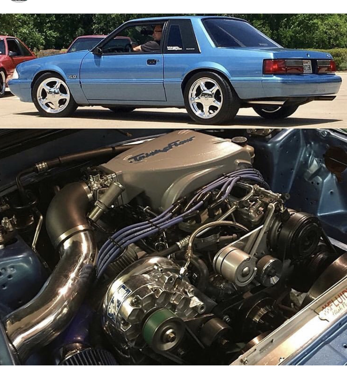

How do you like it? I might go this direction! But I want to keep my power pipe and run a front mount cooler and just fab the piping kinda like this
love it.. no oil pan to punch and dead nuts reliabe.. kinda miss the whine from the Ole S trim back in the days though as this one is quiet due to not having the straight cut gears.. It steps up the boost quicker than the older S trims I had as well. Pretty sure the grearing is better. Just change the oil every 3ooo mles..... I have the HO unit.. It will easily handle 550-600 HP all day long. I made near 480rwhp and dialed it back to around 450rwhp to run a safer AFR.

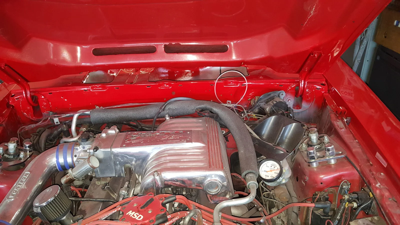

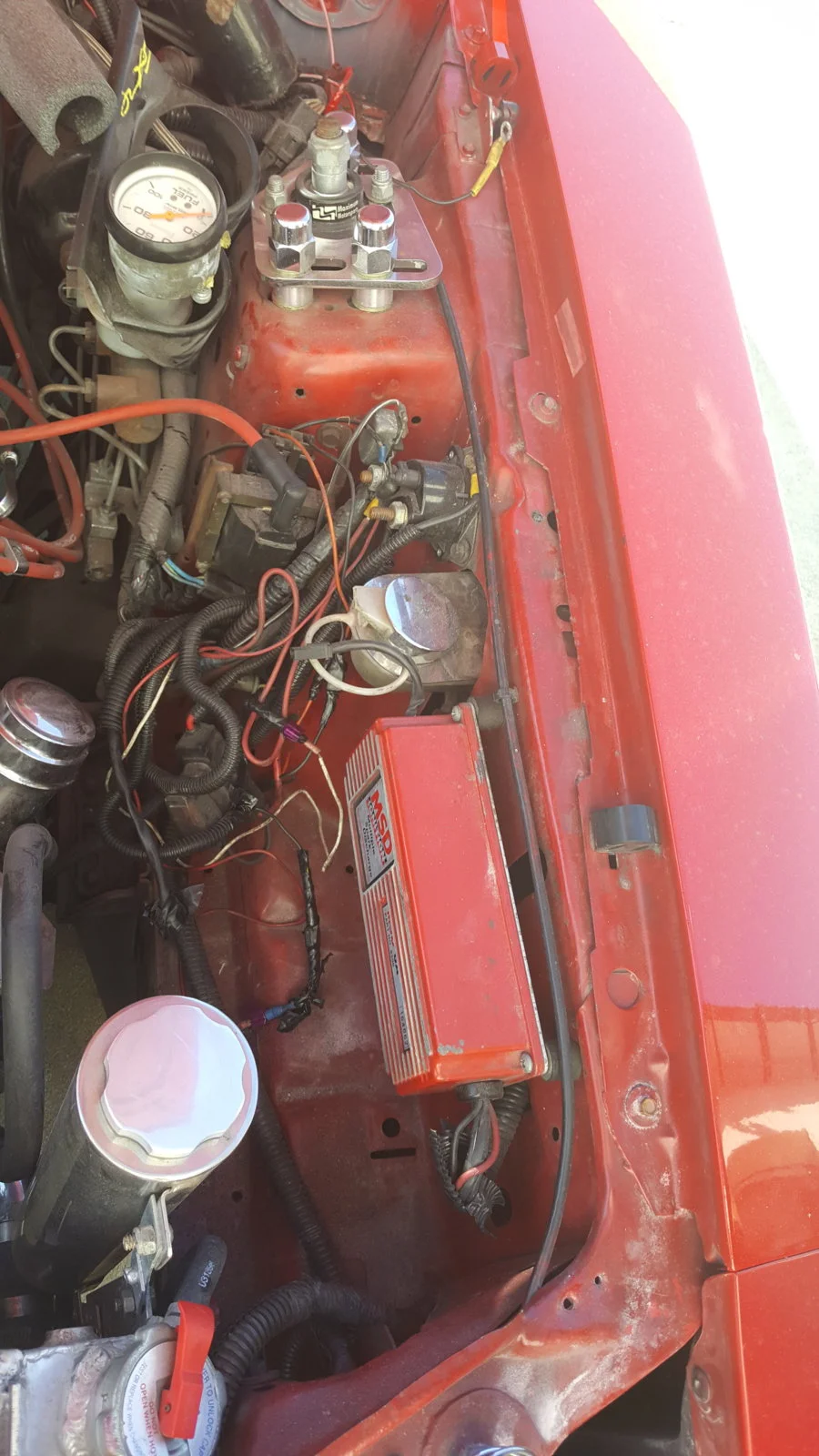

Did you tuck all your wiring under the pinch weld on the fire wall?
Yeah and the brake lines and moved the vacuum lines down as well. Had to retuck all the wires in the driver side as this is what it looked like the day I towed it home. He butchered all the wiring WHY I have no clue.
Yes that is my Cowl mounted FP gauge sitting on the master
the boost gauge was om the back seat and you can see the line laying there open
Loved how they just didnt paint the driver corner of the firewall and inside the cowl

V3 step up is 3.61:1 and the v1 is 3.45:1 - Vortech finally released the heritage blower which is a v3 with the straight cut gears . It’s just as loud as my YSI .
