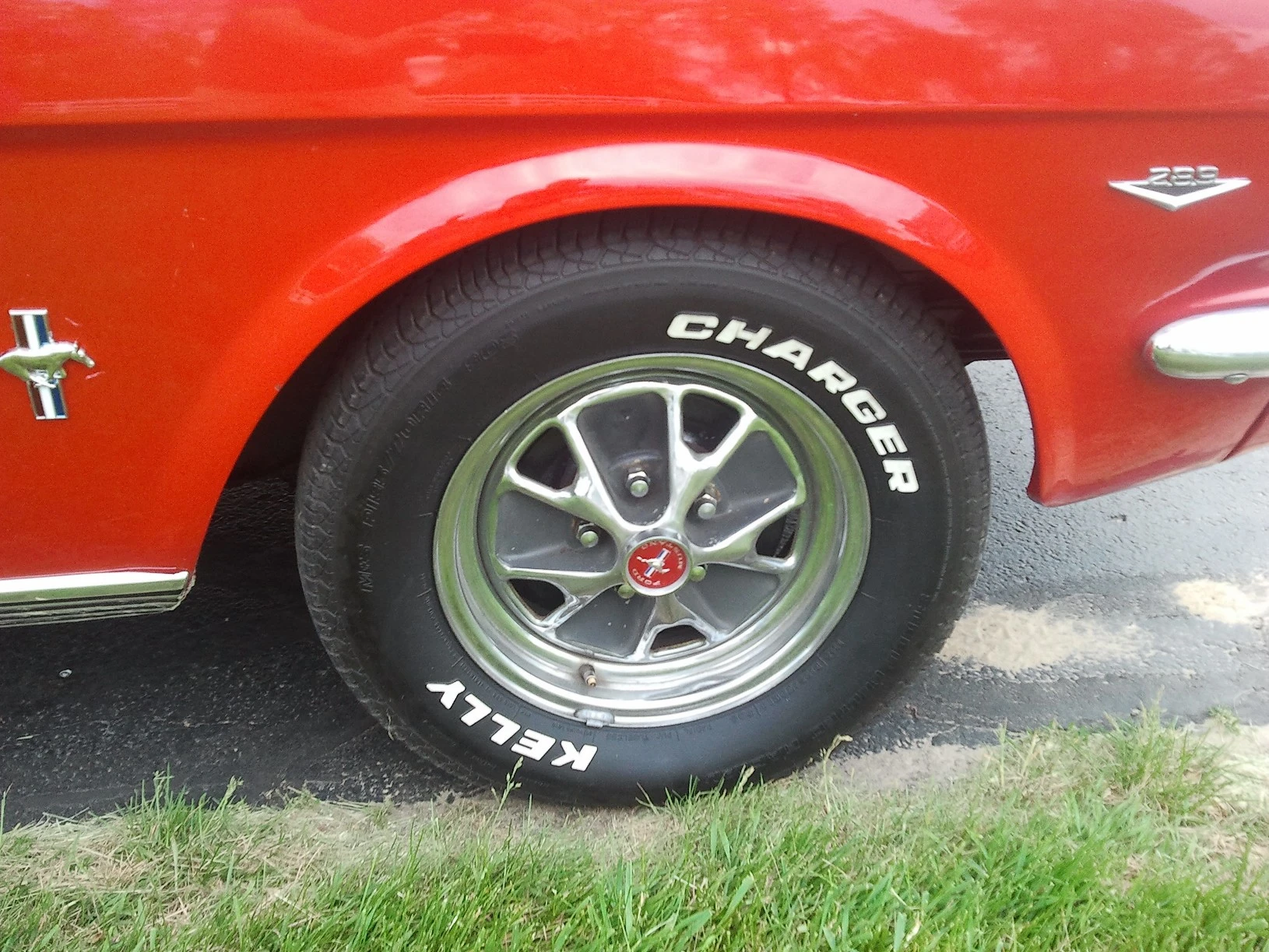

I have a 66 coup with 14" style steel wheels with 195/70/R14 tires. It is at stock height with stock suspension. I dont want to alter anything or roll fenders but want 15" torque thrust Ds. How can I avoid rubbing issues in the front? Would a 15X7 with a 3 and 3/4 inch back space and a 205/60/15 be ok. .

Thanx 65Ccode i read the article. The factory 14" style steel wheel has a 3 3/4 " backspace. With the suspension under load, with new shocks and coils, there is aprx. 1" clearance between the tire sidewall and the upper control arm. With that in mind wouldn't the 4.250 backspace bring the sidewall closer to and make contact with the side upper control arm.
