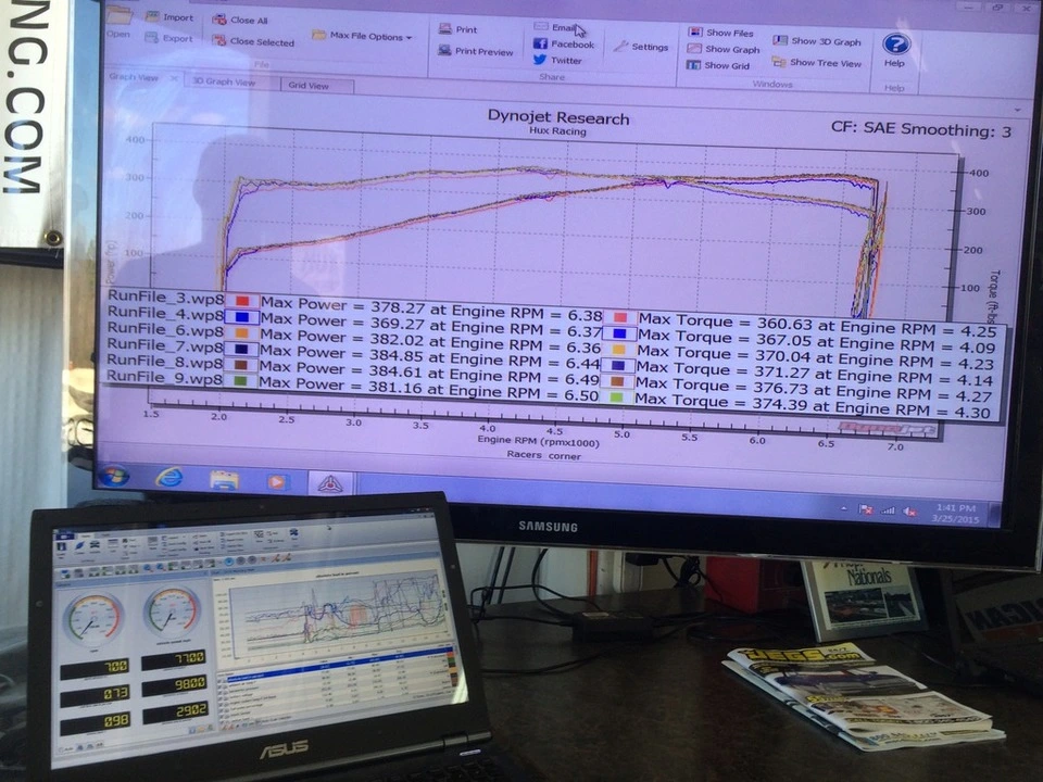

You're really not that far off of that dead stock.
This is my car with NOTHING done to it. No intake, exhaust, tune, etc.....even the air filter was stock.
It's already around 370 ft/lbs at the tires and 30 more really isn't a stretch on a good tune and basic mods. I'm working with Paul at Bama right now to get this tune right and then I'll strap it back down and see what it does. Some of the areas I've been specifically working with when talking to him is the low end response and eliminating the torque management and delay to the TB response, as well as the WOT power.
When all is said and done, 400 ft/lbs really shouldn't be a stretch....

Realistically, if you want 400 ft/bs in the 3000 - 4000 RPM range, here is what you're looking at.
HP = (TQxRPM) / 5252
Let's flip that around to solve for TQ.
TQ = (HPx5252) / RPM
You want 400 ft/lbs, so let's plug that in and our RPM range...
400 = (HP x 5252) / 3000 RPM's
That's 228 HP at 3000 RPM's and 304 hp at 4000 RPM's.
If you compare that to my dyno sheet above, you're pretty close. And most of these cars respond better in the mid range than they do on the top end.

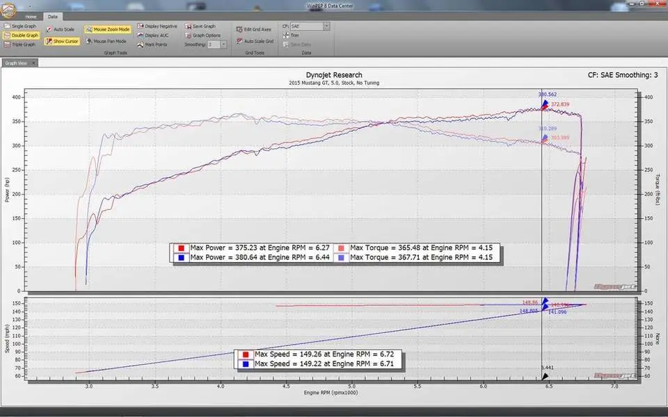

This may give you a better picture. I started these pulls down at 2000 RPM's vs 3000 RPM's. This was nothing but a base line tune that was hitting all kinds of limiters and knock sensors over-reacting and is what I've been working with Paul on. But, you can see the 3000 - 4000 range much clearer here.
The car was initially delaying power for more than a second, the knock sensors were pulling 4-9 degrees of timing, and it was hitting a couple torque limiters that really limited the total output. Right now, the data logs I have vs this dyno sessions are MUCH improved. The car is responding a lot better.
Once Paul says he thinks it's ready, I'll strap it back down and see what we get. I've added the intake and exhaust since this last session, so I'd expect a little improvement just on that, but I'll do 2 more baseline pulls with a stock tune to see where it's at before putting it back on the 93 tune. Actually, I'll run it with the 93 tune that's on the car first and then set it back to stock so it has plenty of drive time on the tune.
Reactions: Fordnut
Thanks a lot for the pic and your input. It looks like the motor starts really 'coming alive' in the 3 to 4k range. I guess I am worried that by improving on the engines breathing (intake, headers, and exhaust) it might want to move the power peaks up in the rpm range. Max numbers aren't my target, looking more for 'fun street' feel.
I guess the proof will be in the dyno pulls after mods. :)
Well, normally with intake and headers what you get is big end numbers. With a larger intake you slow the intake velocity and this is where your torque is. BUT, with these motors, having control of the variable cam timing, you can make some really good low end numbers and not kill the top end.
Most physical power mods aren't gonna give the response you want in that RPM range, they're geared toward the big end. Tuning will get you low end numbers.
But yes, this motor LOVES to rev. I've never driven a mostly stock car that responds so well over such a broad RPM range. Literally, wherever you smash on this thing from 3000 RPM's to redline, there is good power.

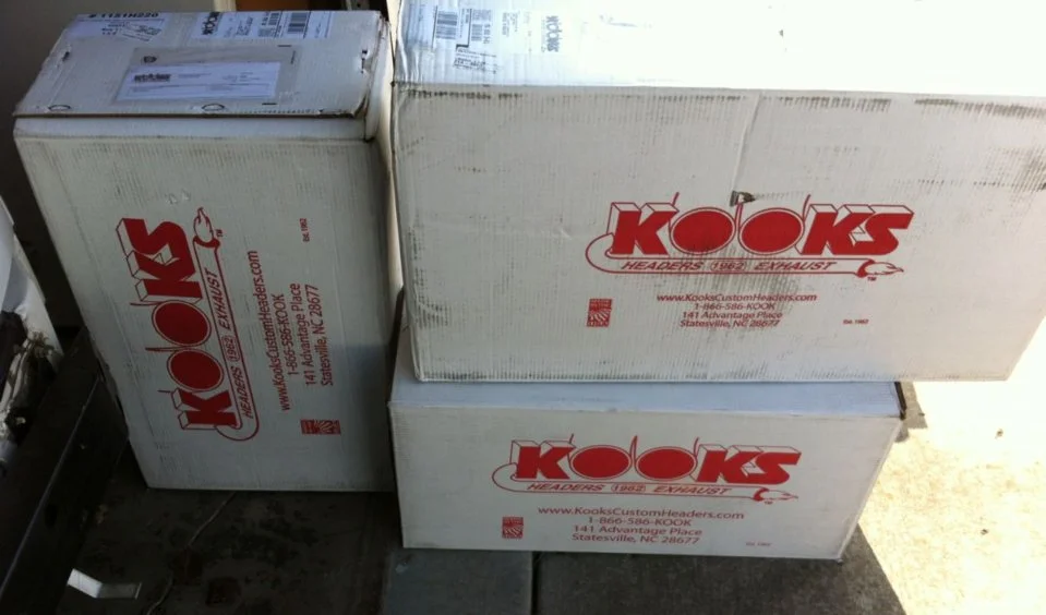

One step closer... UPS man strikes again, leaving another pile for me at work. Now all I need is a CAR to start installing stuff. :)

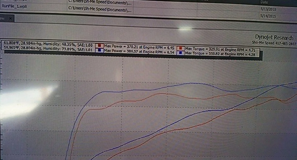

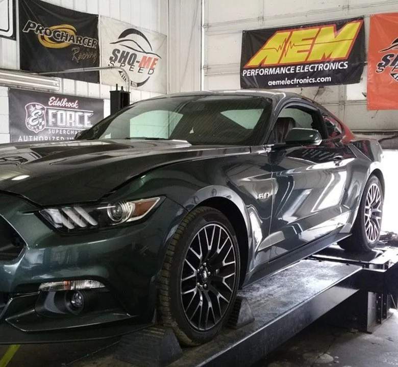

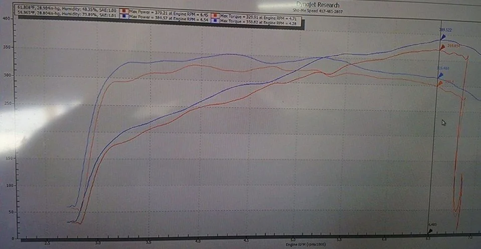

Well, the numbers don't lie... and I'm a little disappointed. Expected a tad more, but don't we all? ;)
Got right at 20 Hp and Tq both, with more under the curve.
I hope she gains a bit as the motor loosens up- just over 500 miles on it now.
