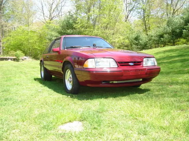

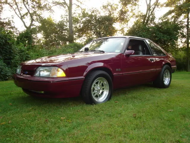

Clearly Rick you have no idea what your talking about something is wrong. 19059020 people with foxes run a 10" wheel with 6.5" BS with NO problems. I am one. Here are pictures of BOTH. The 10" wheel DOES NOT stick out. It makes the tire rounder instead of buldging on the wheel.
15x8 5.5" BS 275/60 tire
15x10 6.5" BS 275/60 tire
No no. I said in my previous post I rolled the quarters which didnt NEED to be done, and i hammer the fenderwell. To me thats no problem. The pictures were to show the 10" wheels DONT stick out 1". I am sick of the he said she said bullsht that people say. Wrong information doesn't help anyone. If your asking for your SN95. I believe you have a little more room to play with but thats something to research.
