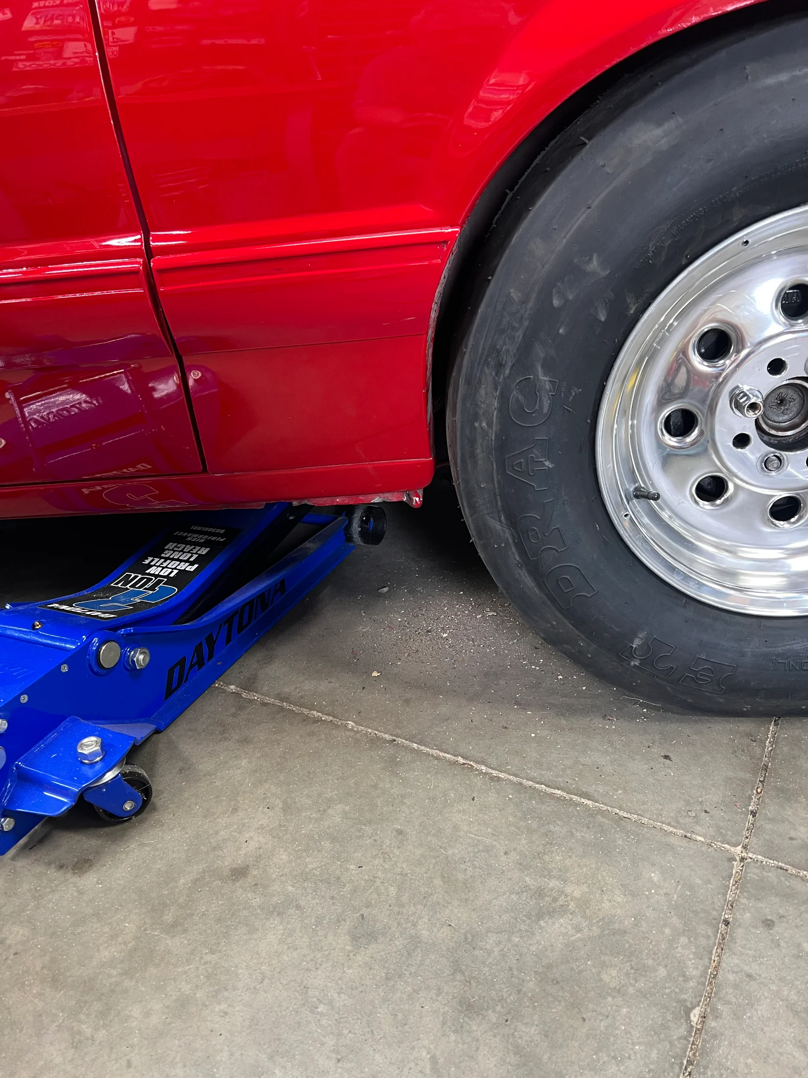

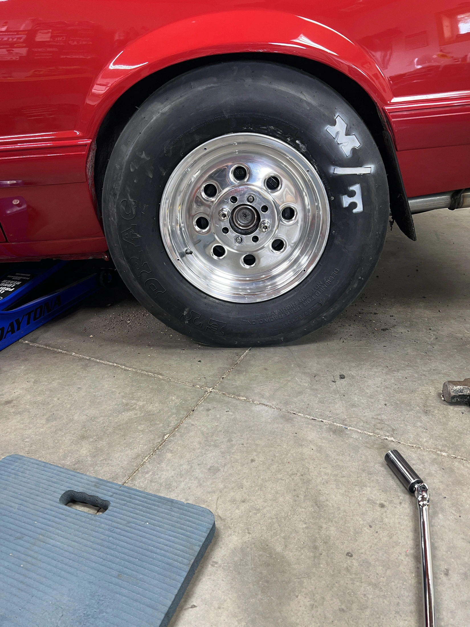

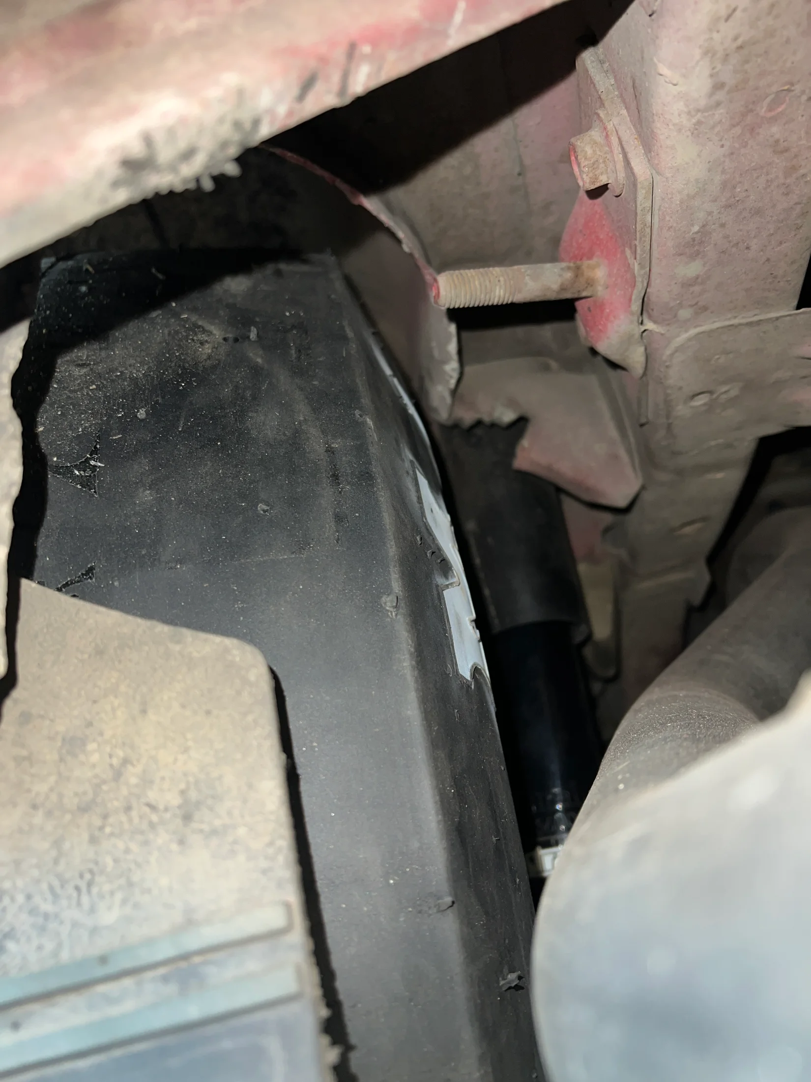

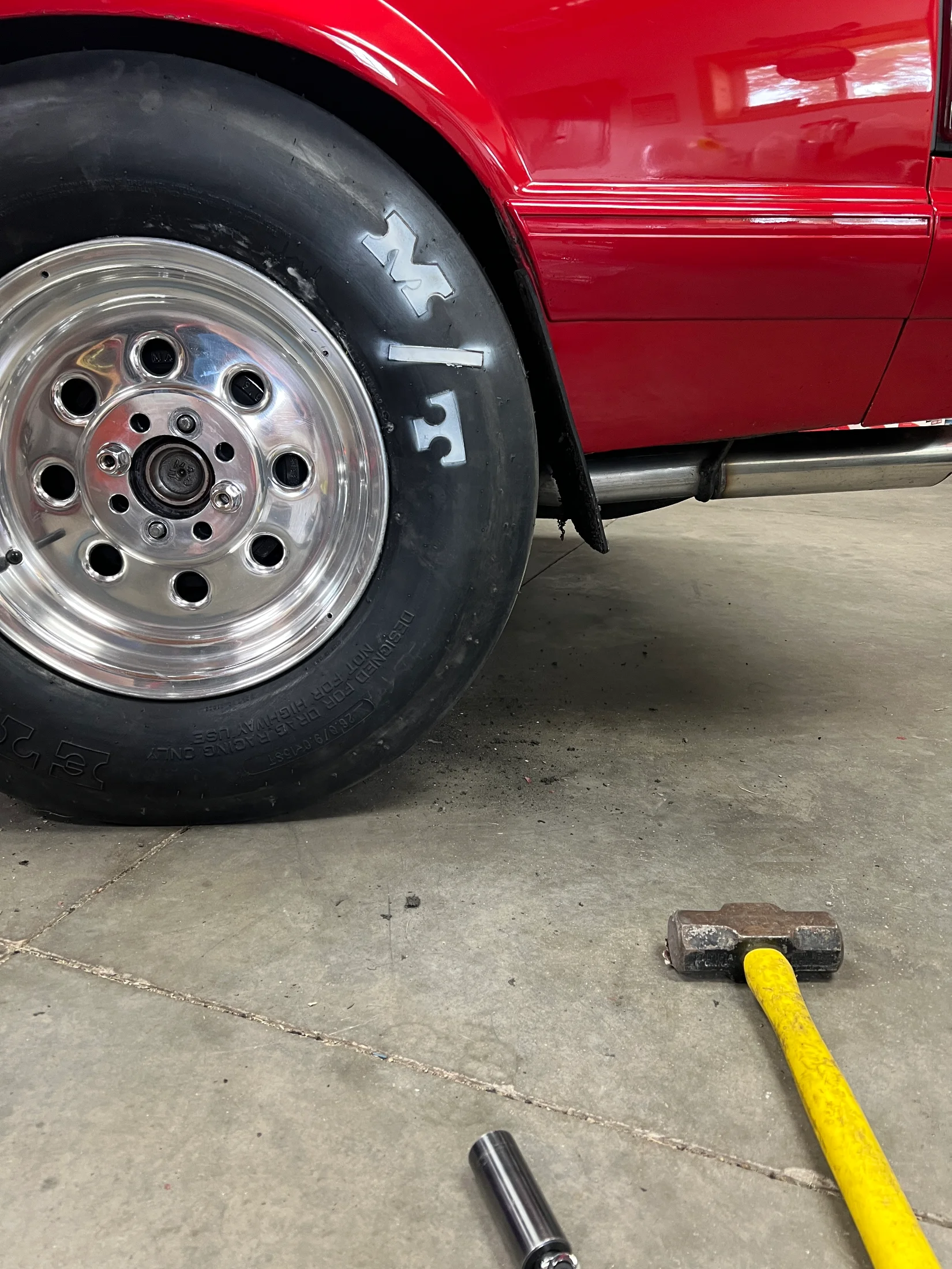

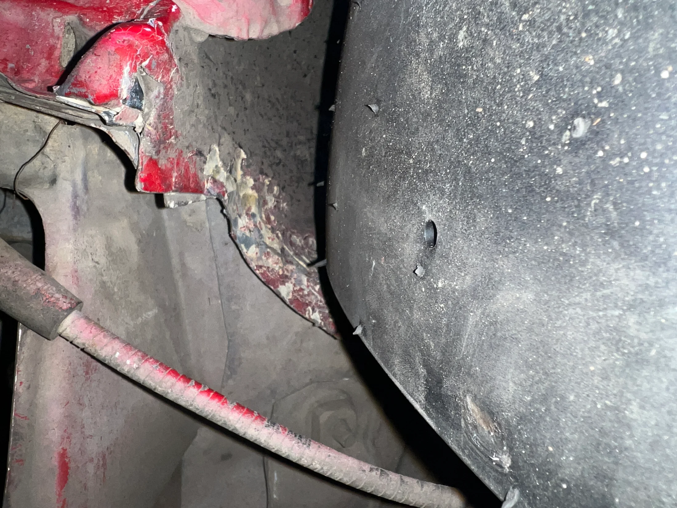

Anybody run the Mickey Thompson 28x9x15 slick? Wheels they're mounted on are 8" wide with 5 1/2" backspacing. Car is an '89 LX, no quad shocks and MM control arms with adjustable spring perches. I massaged the inner fenders with a BFH. Looks like it should be enough clearance to me, but wondering what you guys think. I usually run a 26" tire, but want to give a 28" a try to see if I can improve times a little.

I have 275 Drag Radial on my 89'
Measures 28" X 10"
On a 10" wide double bead-lock 15" wheel
Rolled the fender lip and a little 5 lb hammer near the upper spring perch.
No rubbing issues on launch? My fenders are rolled also. I know a bias will grow a little at speed, but if you don't have issues with that tire stuffed in there, I think I'll be fine. Great looking car too!
No issues on launch.
The only time I get rub is going around a corner or over a bump.
Sidewall flex is the cause. Only 17-18 psi in the tire.

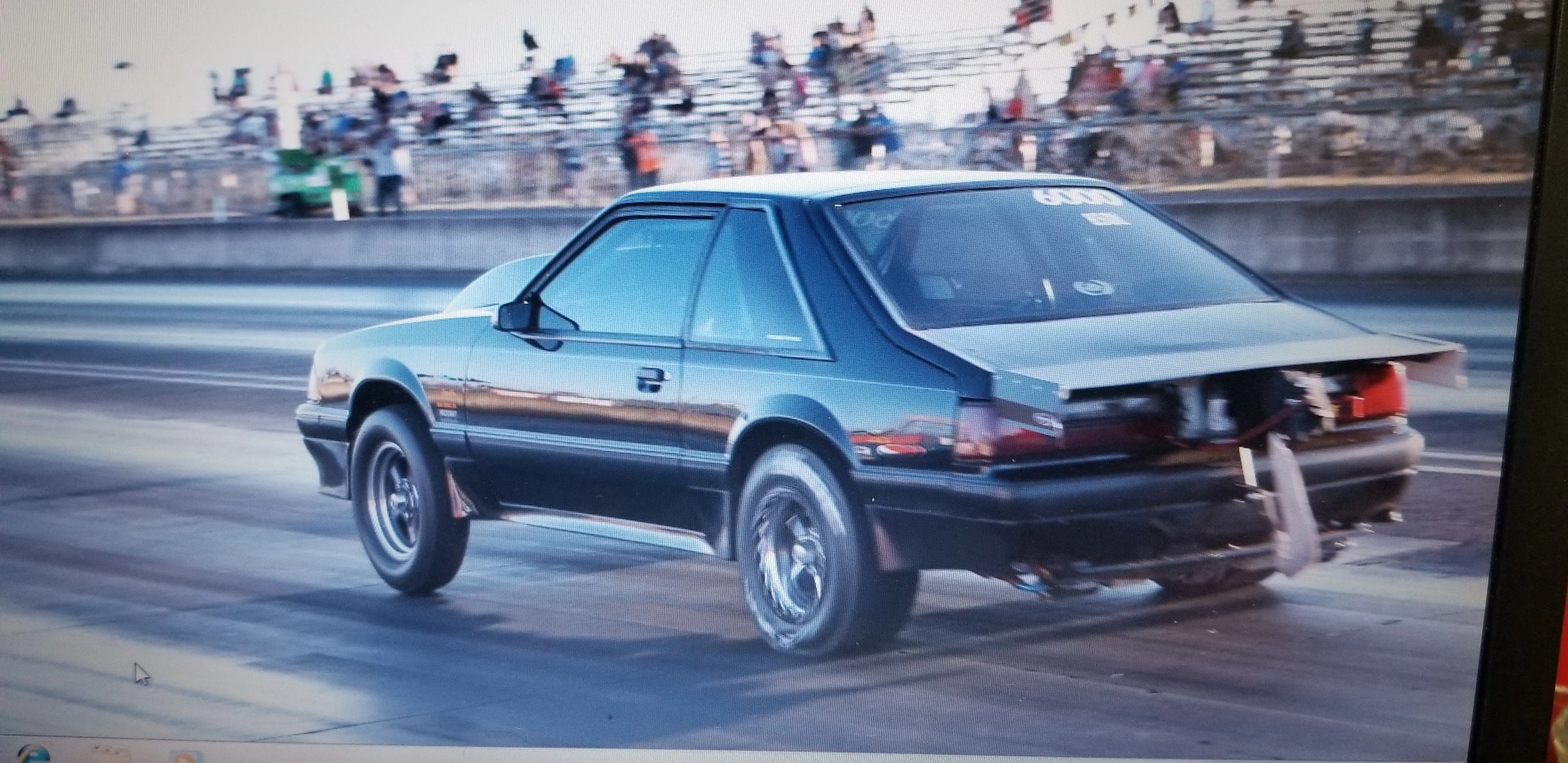

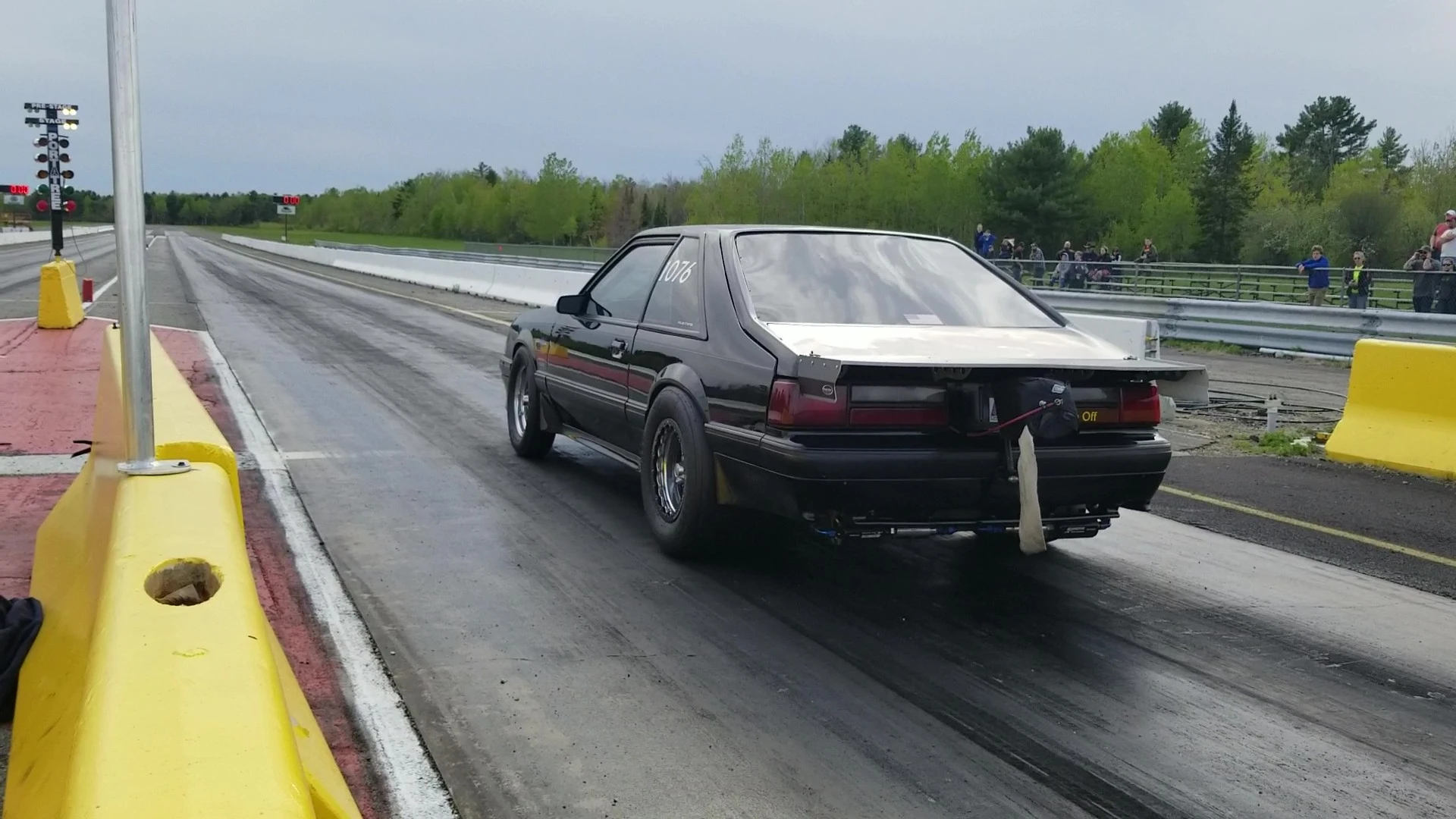

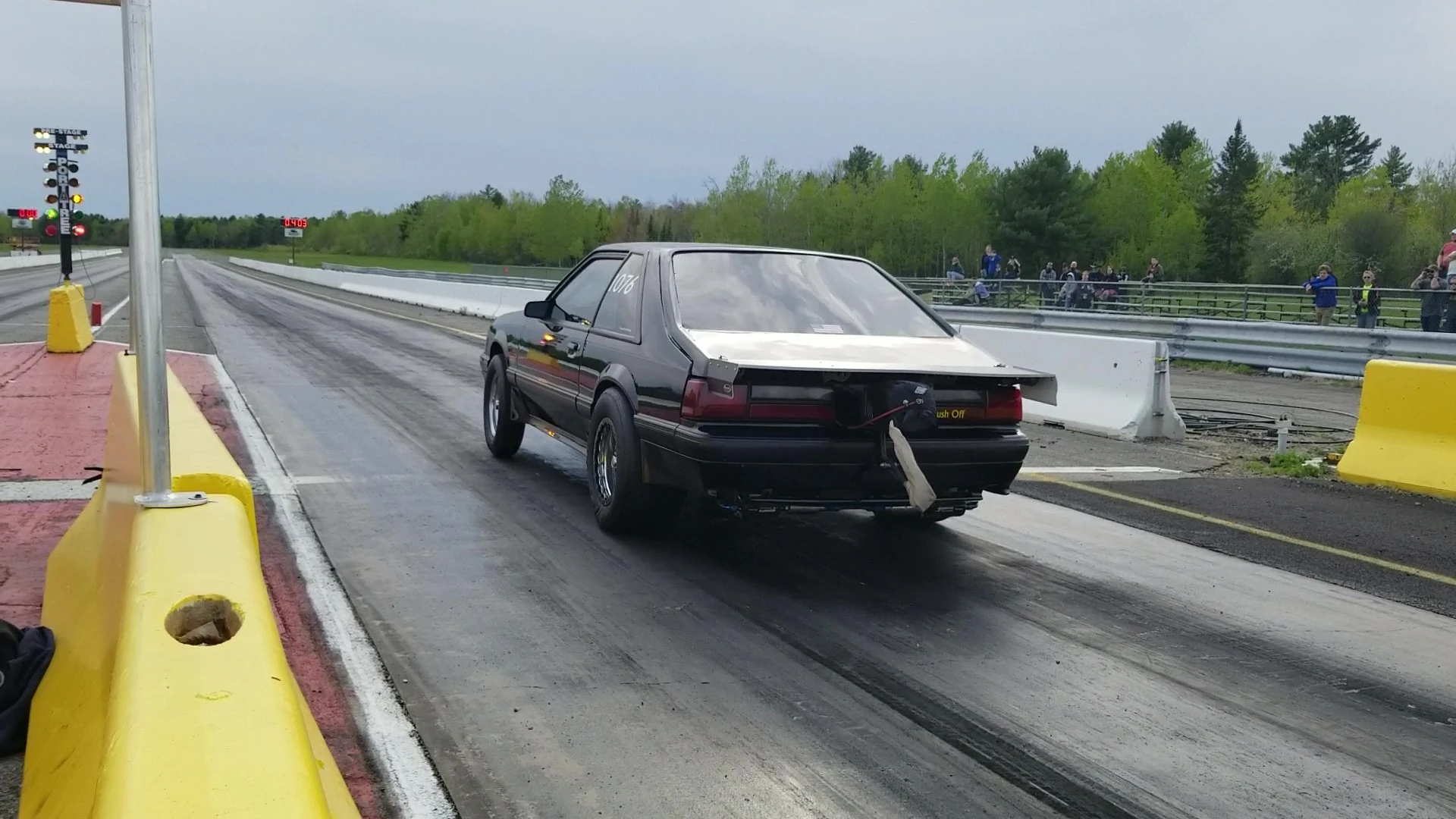

Here are two pics, first is stationary at the line, the other is at launch.
You can see that the rear fender is higher at the hit, it maintains that gap during the whole run.

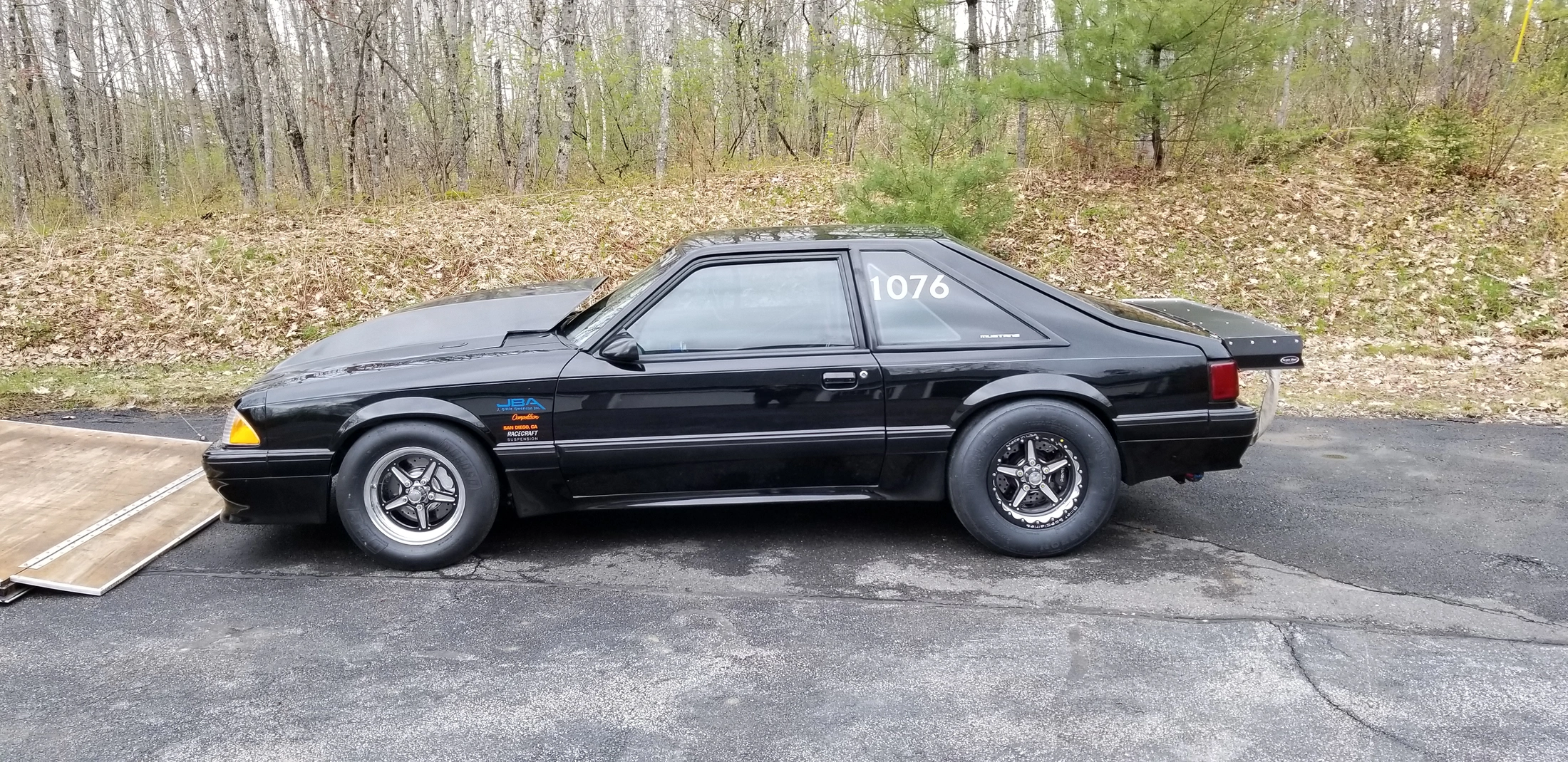

I bought 28x9 Hoosier Slicks and thought the clearance was too tight. I even bought a fender roller. I never ran them.
My car really squats when it launches. I knew they would rub. I went back to the 26x9's.
My car is a 93 GT. Less clearance than a LX I believe.
I had them on 8" wide rims 5-1/2" back spacing no quad shock too.

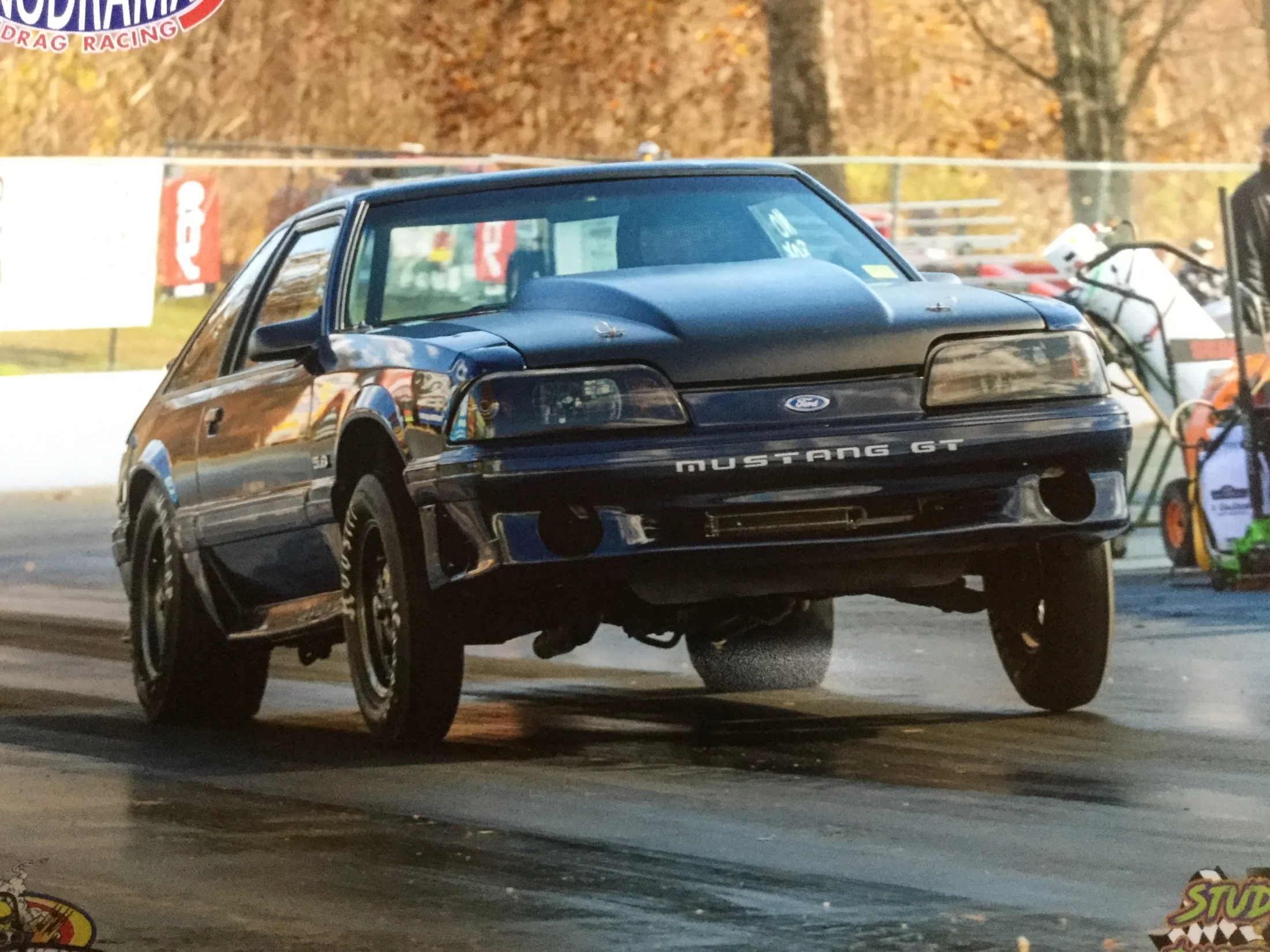

If it squats on launch, then the rear suspension geometry is not correct.
The rear should lift. It is planting/driving the tires into the ground a that point.
If it squats, it is trying to lift the rear tires off of the ground.
I guess stating that "it really squats" was the wrong terminology lol.
I don't know.
Looks like a good launch to me.

I've got adjustable shocks and control arms with adjustable spring perches, so I don't think the squat will be a problem. Going to bolt them on and do some street launches and see how they do. If they give me too many issues, there may be 4 wheels and tires for sale.
