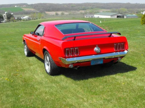

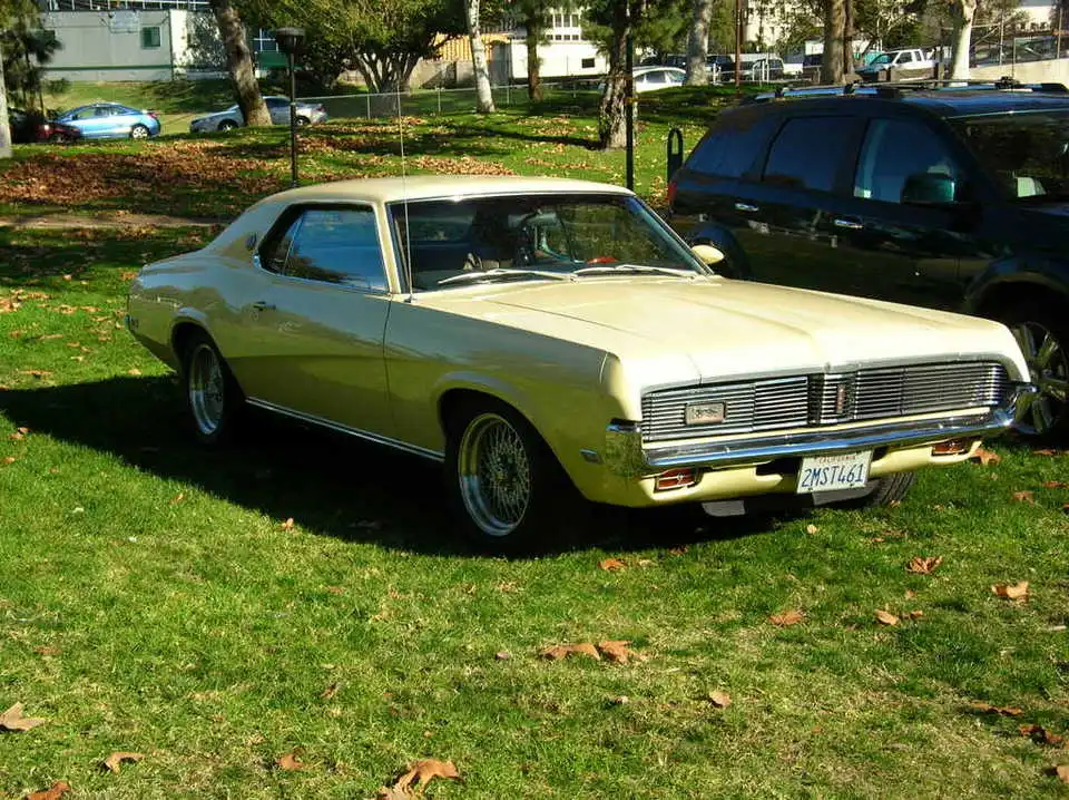

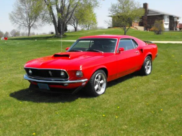

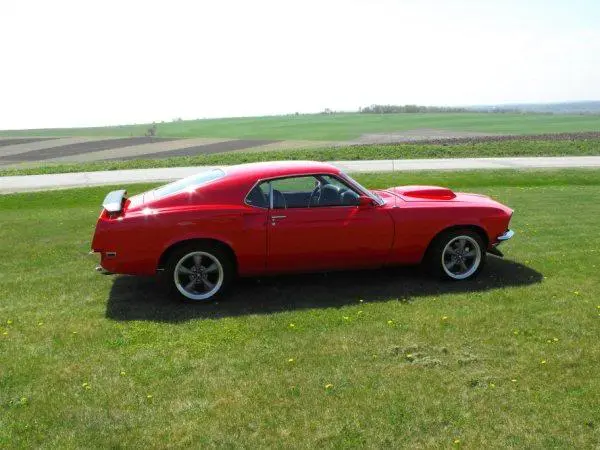

16x7 wheels, 4.75" backspacing. Grand Marquis Sport wheels. 225-60R16 tires.
The Grand Marquis wheels seem like a good choice for the Cougar. I've thought about getting some for my '67 Mustang but I also like the late model Bullitt wheels which are available for about the same price. Running Bullitts though would require an adapter/spacer. I guess the 16" Grand Marquis rims can work with no spacer, but not sure.
