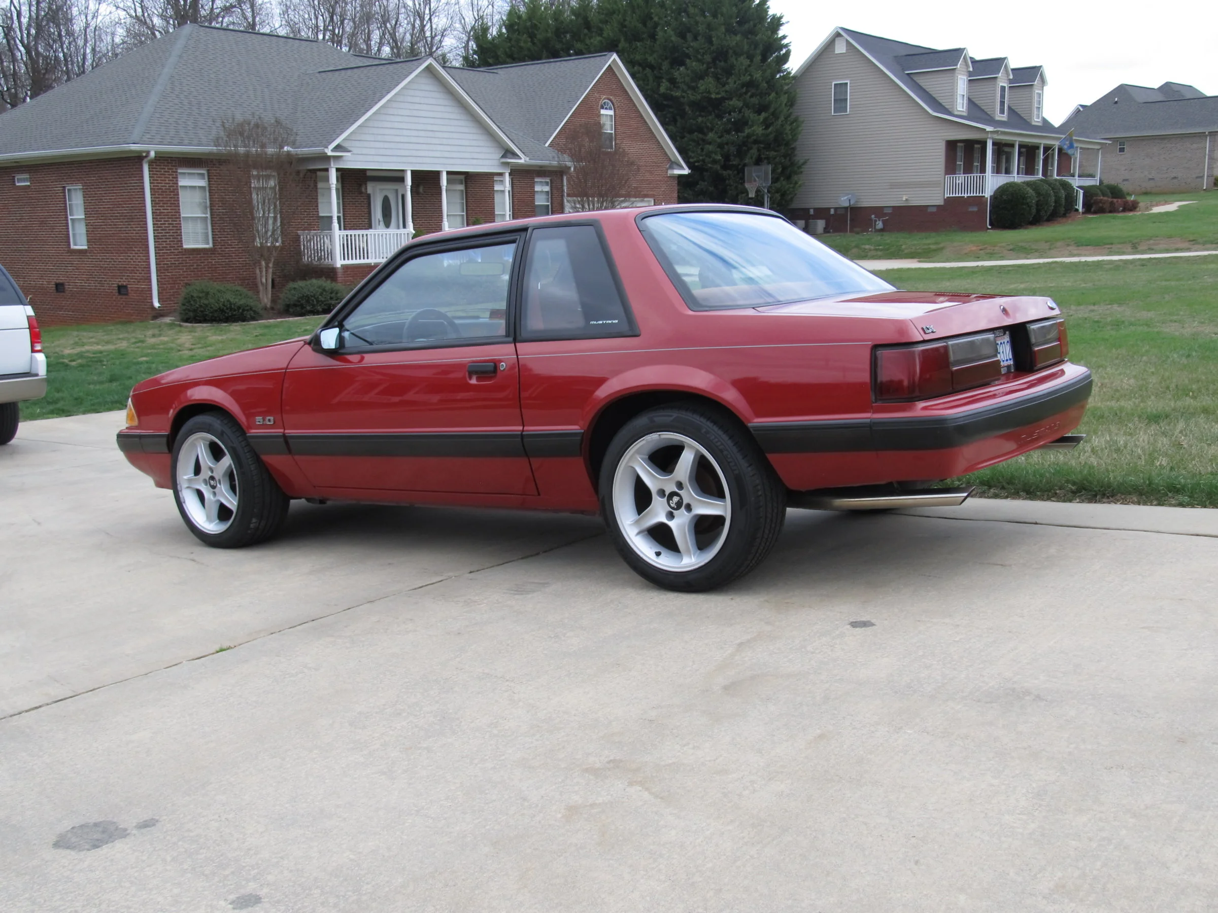

Once upon a time .... 17x8.5 245/45/17

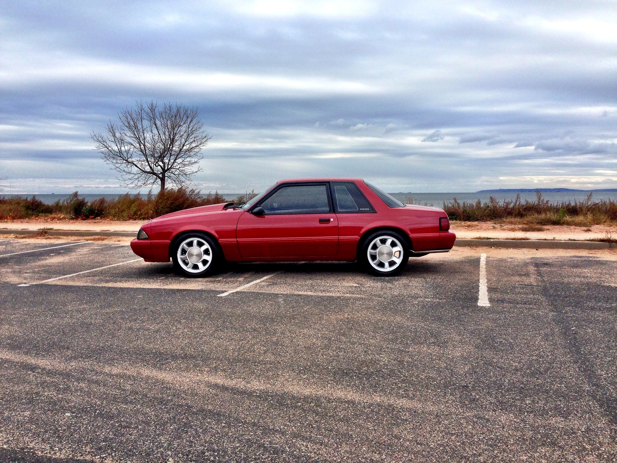

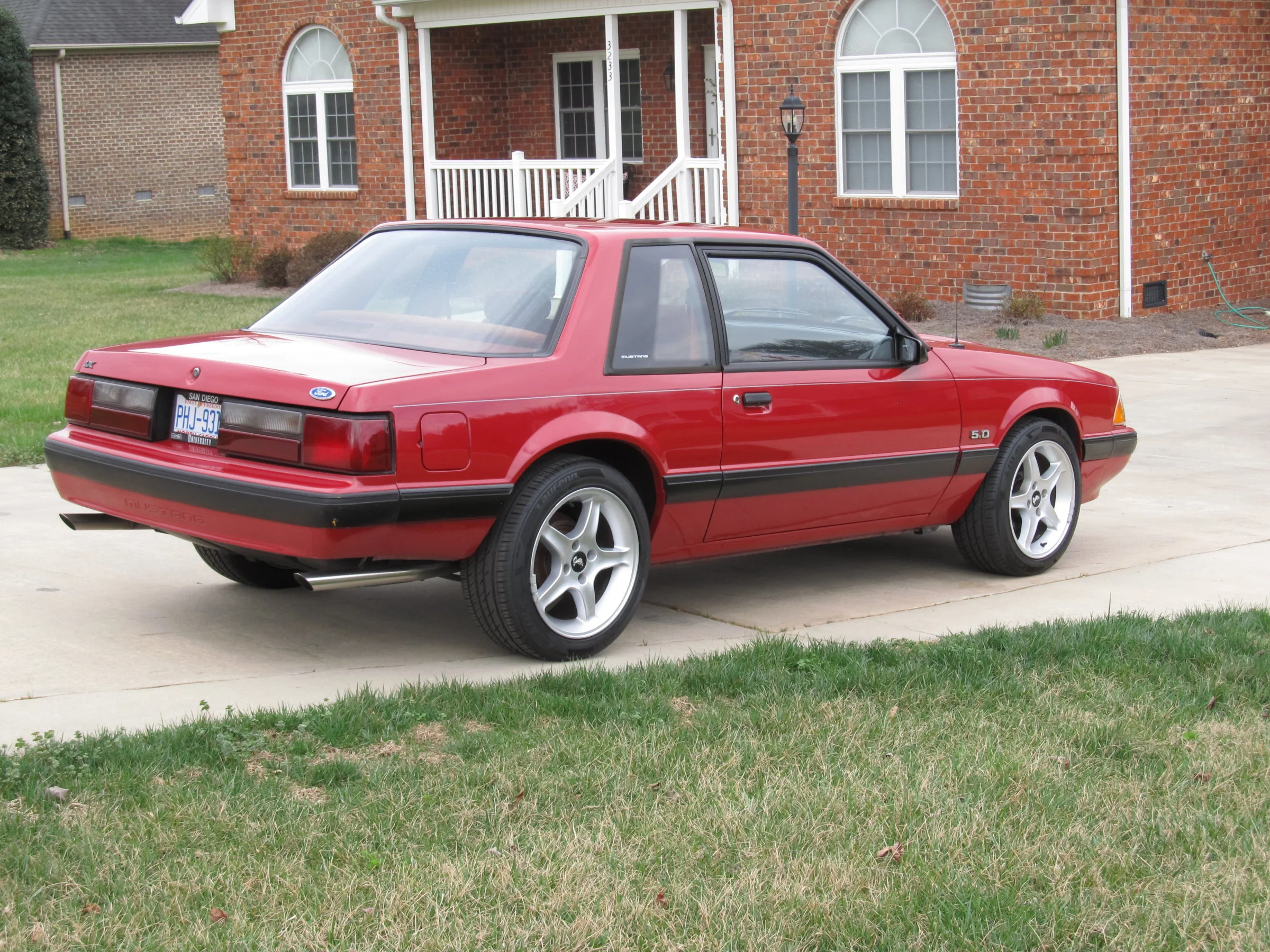

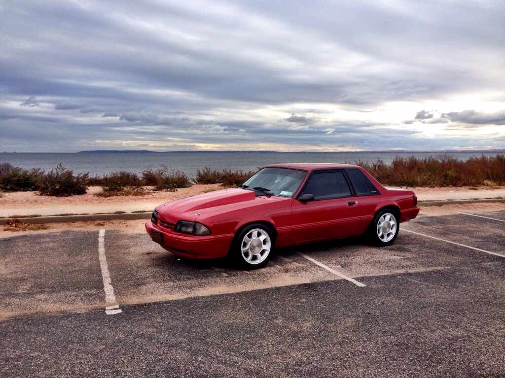

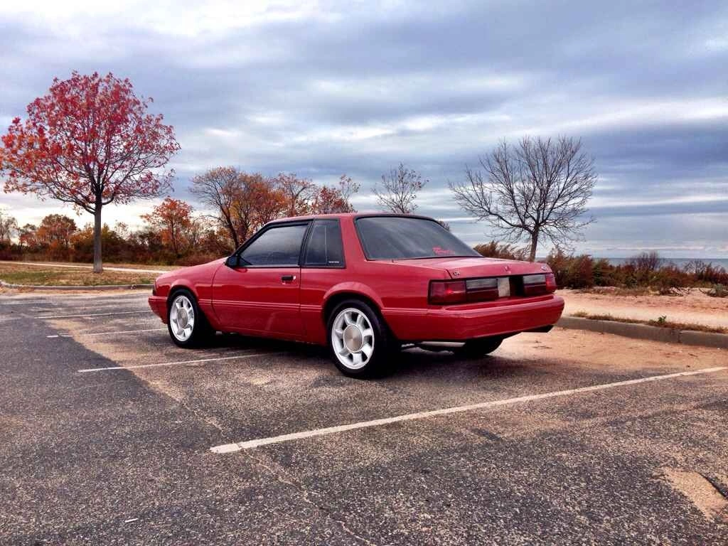

I got a set of used Ford cobra R's with new 245/45/17 on, here is a couple of pics. been cleaning up the engine compartment. still on the fence on whether to paint the body trim body color.

I have a 89 GT that`s oxford white and thinking about Ford`s 93 electric red! I have searched pic`s of GT fox body`s in electric red, but most of them were shaded under tree`s! I really like that red on your 89 coupe, it looks awesome! Could you let me know what red that is and the paint code? That would be so cool! Thank you very much, Chet from Ohio.
