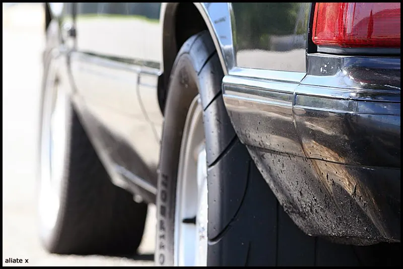

I am running a 255/50 on my stock ponys. Looks good when at full psi (they are BFG drag radials). The squat and hook great when lowered to about 18psi for the track. I normally run about 25 on the street with them and can't complain.
