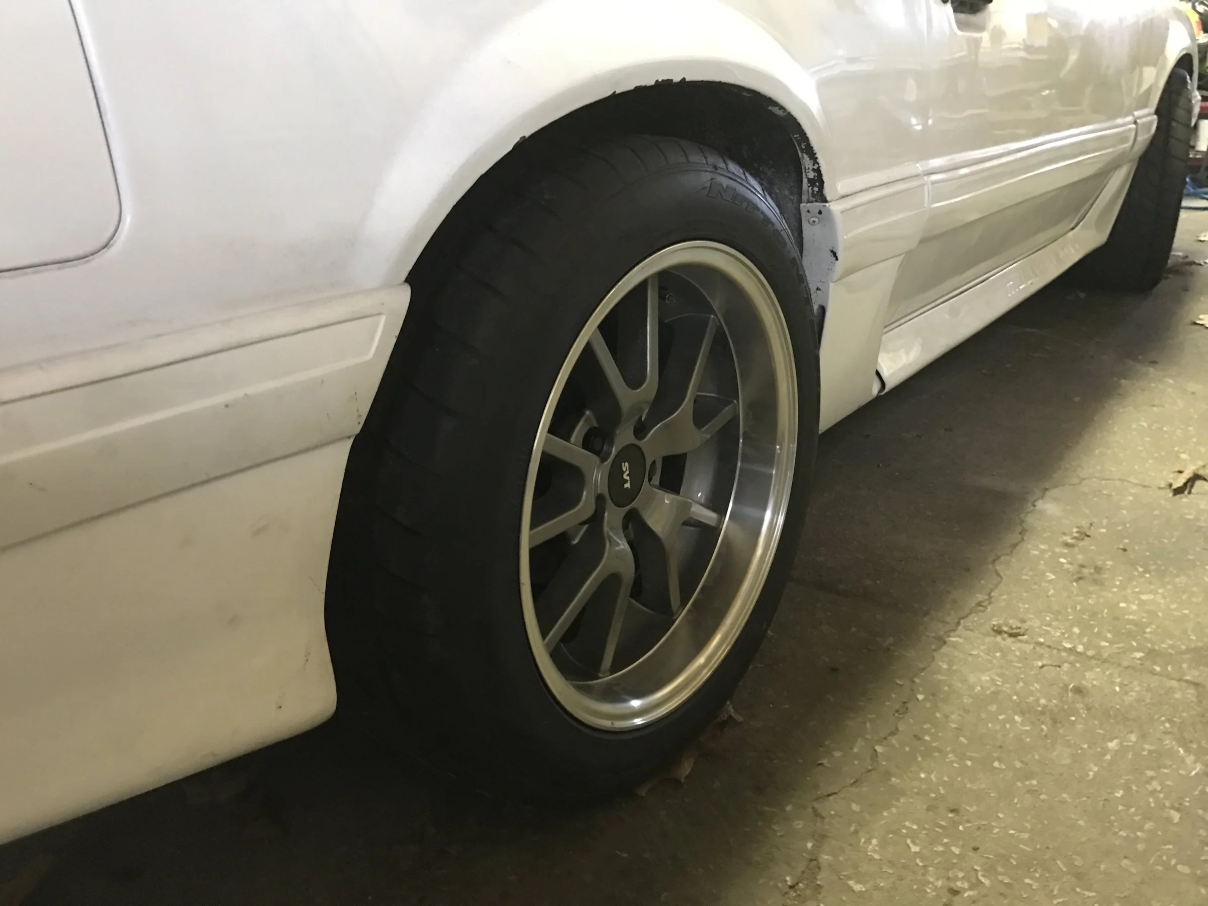

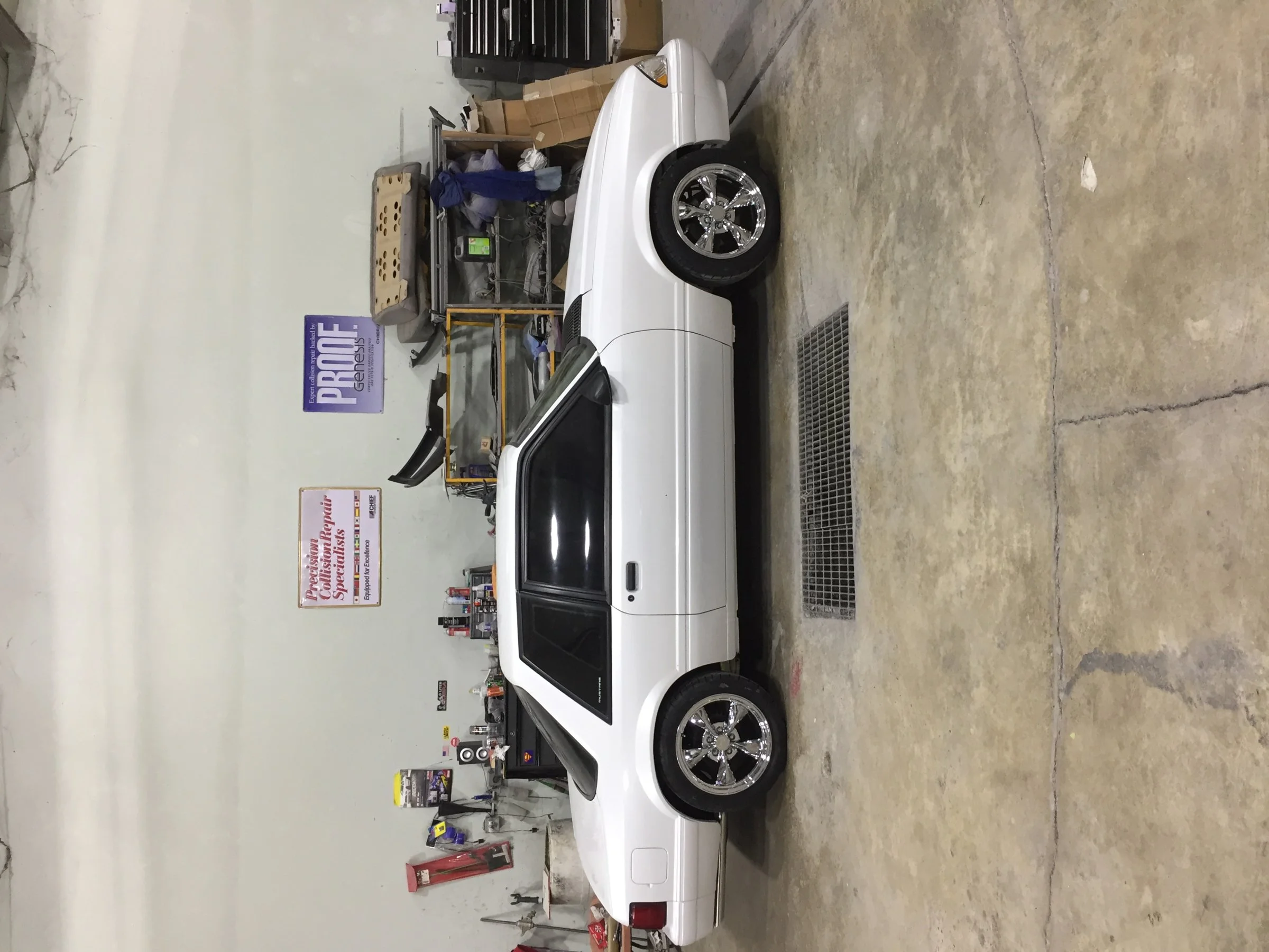

I'll post some more pics when i get home. My last wheels were 10's with 275 and they were a bit tight , these look perfect.

I like. I have the same wheels and 315s. Struggling to make life happy while they are in motion. Look killer on the driveway though. Next time you are under the car can you tell me how much distance you have between the tire and upper shock mount?
