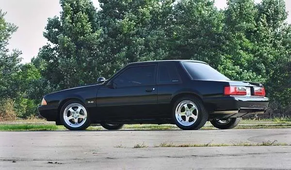

Below is a pic of my setup, you will need to make sure you use 94/95 spindles up front, on the rear if you plan run 10.5 inch wide wheels you MUST keep the stock fox trackwidth. My car has a SN95 disc rear under it but I had to use some ranger axles and the North Racecar brackets. Also on the rear you WILL have to roll the fender lips, no getting around it, I tried and mine rubbed bad! I also had to add some steering rack limiters to the front.
255/40 on the front and 285/40 on the rear, FMS B springs.
