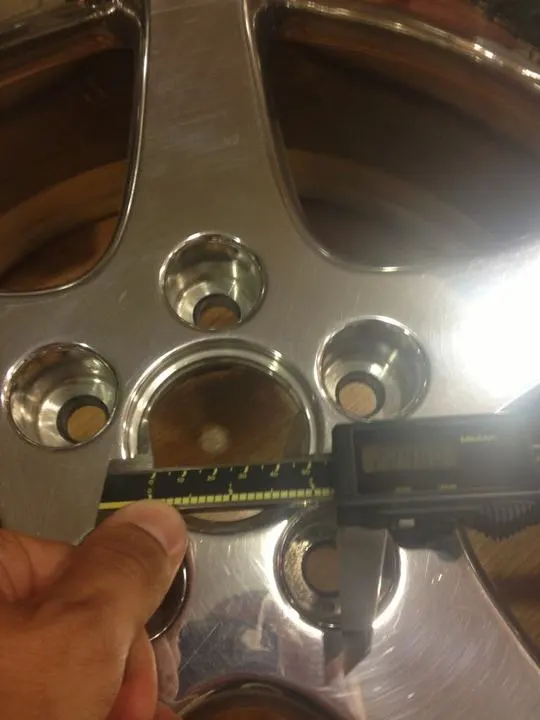

So now on to my next concern. I want genuine caps and am willing to pay for genuine caps. I just need a few things answered for me. I need to know the size face of the '95 Cobra Rs. Is it truly 2 1/4" or is it 2 3/8"? This is why...

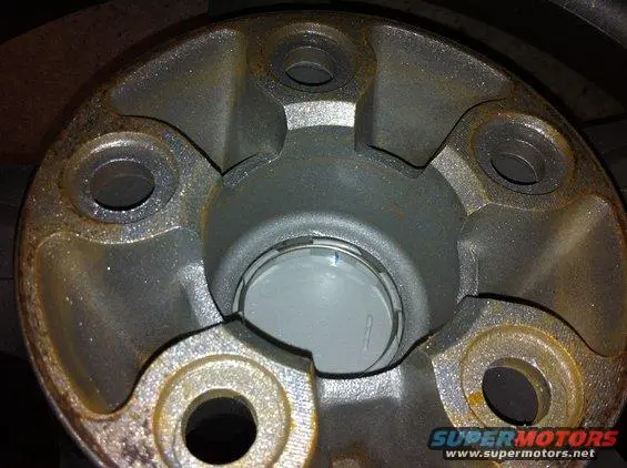

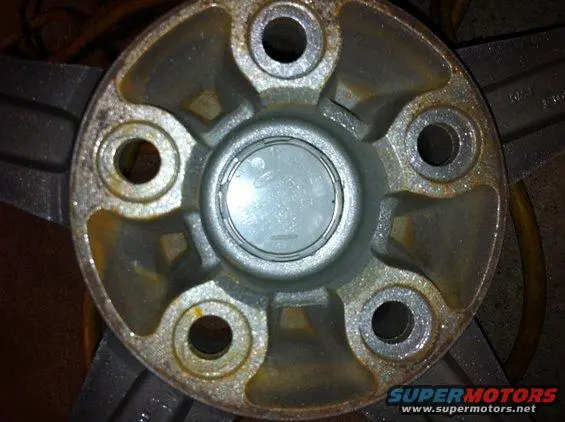

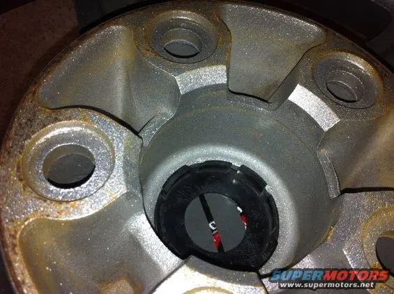

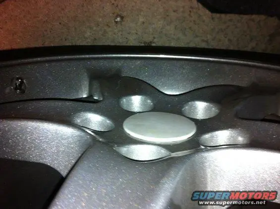

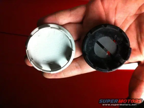

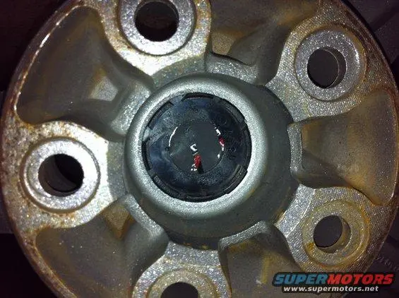

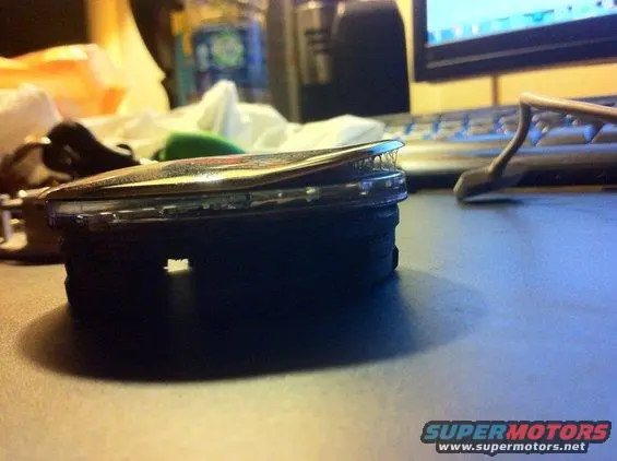

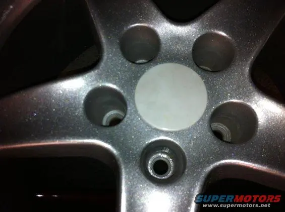

The Speedware center caps are 2 3/8". I'm hoping that Ford rounded off the number to the nearest 1/4". Anyways... Here are the 2 1/2" center caps on my wheels. They stick out! Now they fit but don't seem to sit flush at all. This is just the backing part, does not include the actual top image part of the center cap.
The pics above would somewhat work, if the inner clipped portion would actually clip in properly... Because the face is too large to sit in the bore, the inner clips don't reach to be fully secured inside.
But the Speedware ones do... Obviously!

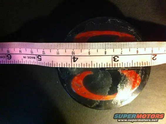

The Speedware inner clips measure 2" in diameter. The factory Ford backing center for a 2 1/2" center cap measures at 2 1/4"

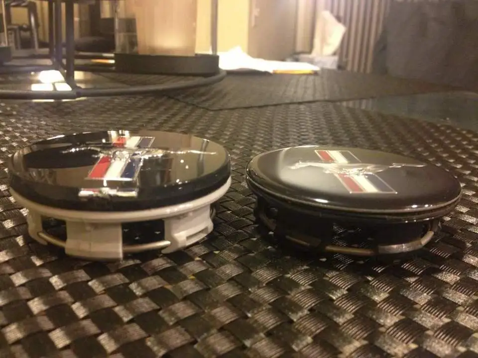

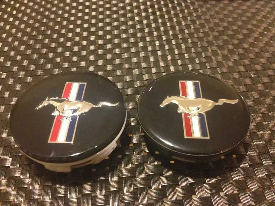

Bullitt wheel cap on left, 03/04 premium cap on right. The bullety caps are MUCH nicer. The pony is more defined. You can see what I mean by they stick out more.
Top view.

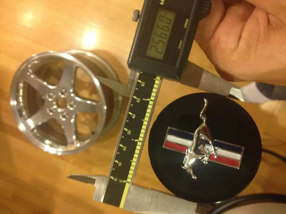

Now for measurements. The outside facing part is about 2.5" for both caps
The inner part of the wheel the fingers snap around is 2.25"

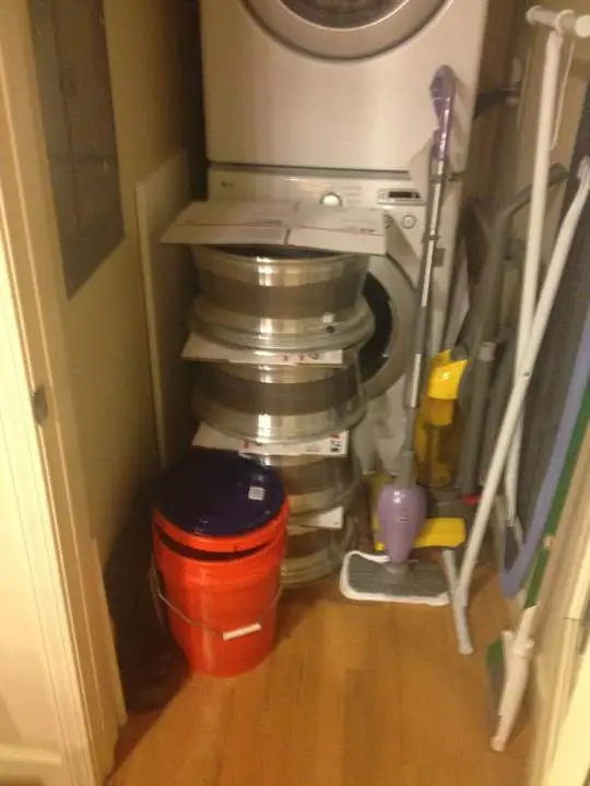

And yes...car parts in your laundry room is perfectly normal.
