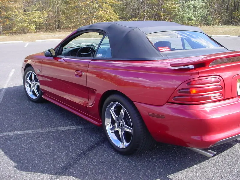

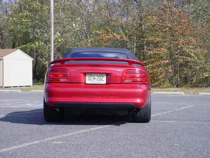

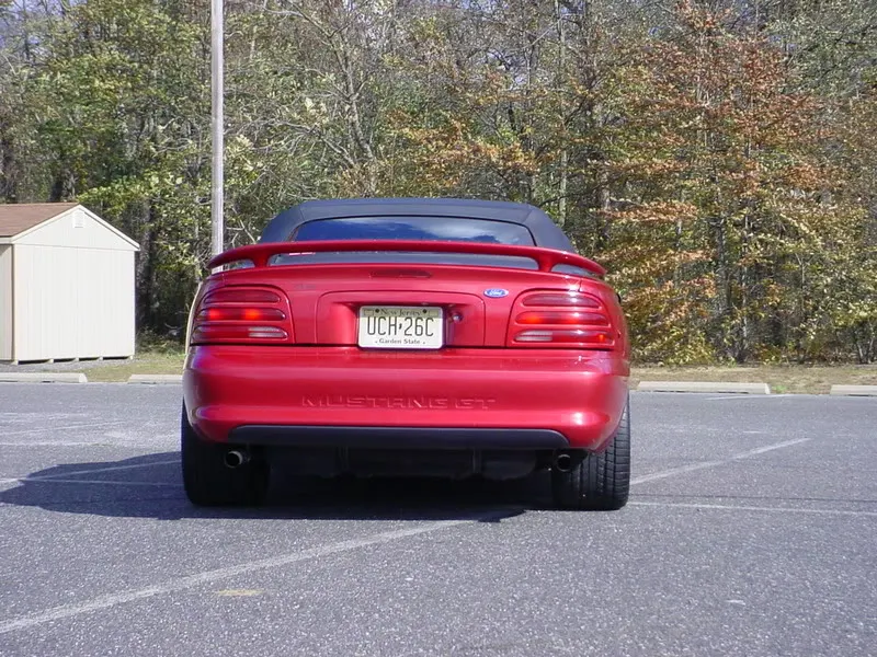

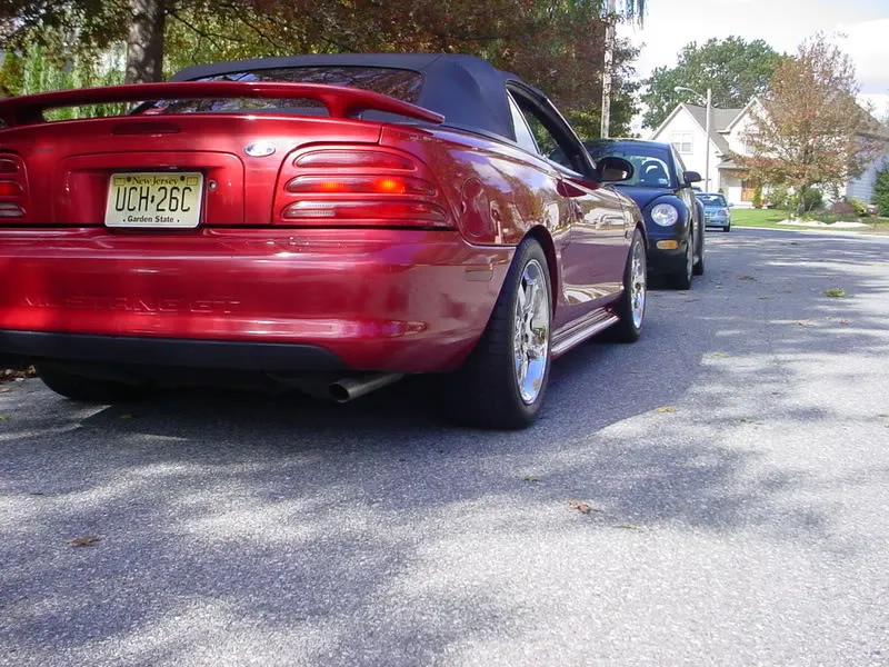

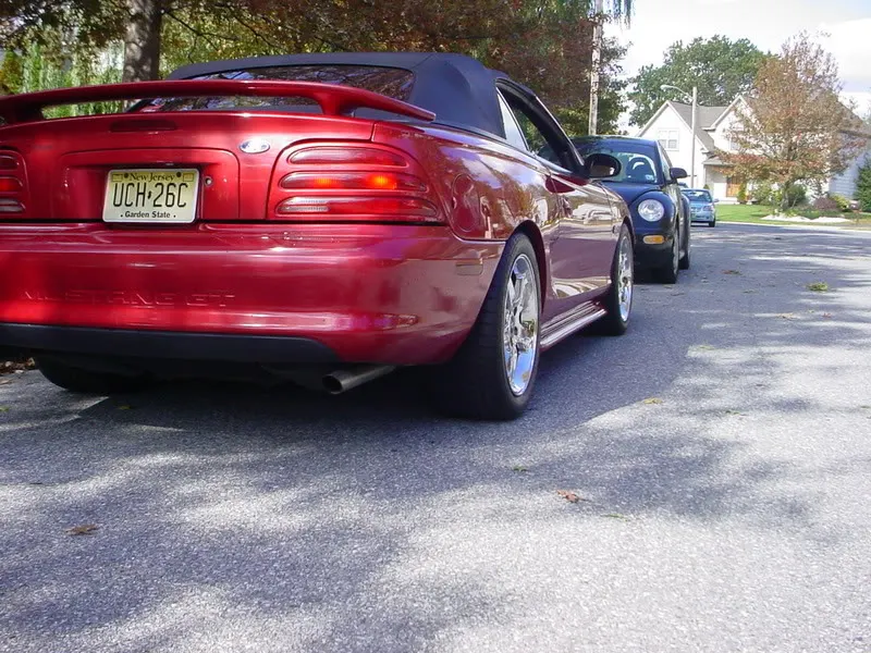

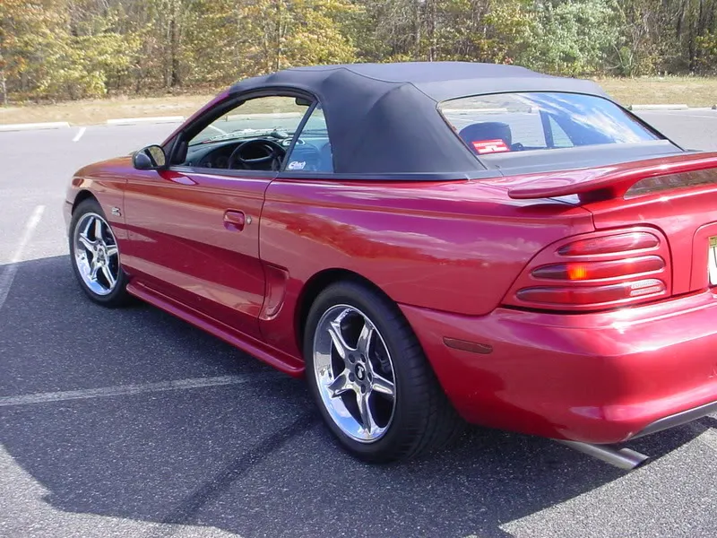

fitting 315's out back aint hard. you need to beat in the inner wheel wells with a BFH... and flip around your quad shock... or just take it off.... you should be good on the flowmasters. mine are close... but dont rub
Pic whore:

Thanks for the pictures. That looks friggin' bad ass. Just the look I'm looking for. According to AM, they claim they are a direct fit and should be any problems, but seems like yo had to do SOME mods to get them on there right?
Do you get any rubbing when carrying passengers or going over rough roads or terrain??
i have scrapped on a hard bump while turning. mind you that i have sportline springs on my car so its slammed. but they did hit the inside wheel well so i did have to hit it with a hammer a little no big deal... the tires have not been cut up bad or anything.
