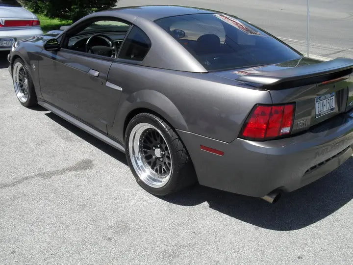

Shooting for a similar stance here (random googled pic):
Those springs should give you a good stance. It is worth it to pick high quality shocks / struts like bilsteins or MM’s in house brand. I would install a bumpsteer kit and CC plates - helps make alignment easy with a lowered car. Set camber to neg 0.5 deg, caster to positive 4.5 deg, and toe to 0.5 deg toe-in.
With the NT555G2’s you should have a well handling car. Having a well handling mustang is addicting - I’ve been slowly picking up the entire MM catalog over the years.
