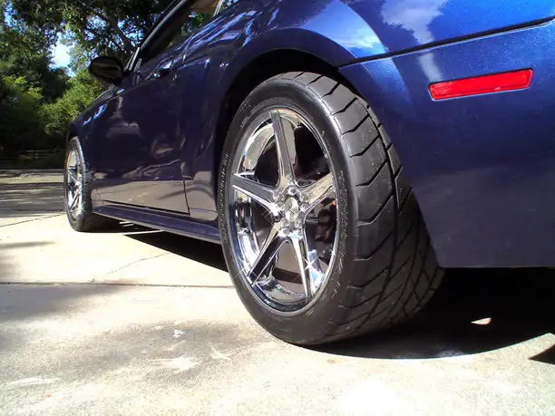

wider is better, but to let u know, wider is alot more expensive to replace. my buddy at work had 17x9 and 10.5's on the rear and the 10.5 he said where a pain in the ass to replace cuz of the limited selection and price. if thats true im not sure, i havnt looked into it. heres a pic of my 18x9's. id also stay with same size rims so u can rotate them unless u going s/c or more hp.
