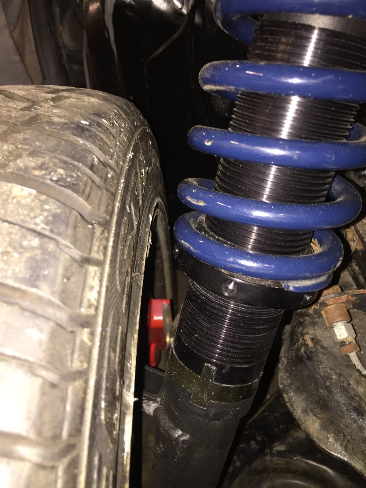

These are SN95 17x8s with 235/45/17 and MM coil overs on sn95 conversion brakes
Whether a 17x9 fits and rubs ultimately depends on the offset and backspacing.
Given the specs for the 17x8 wheels you can compare to your wheels specs and compare.
Thanks for the picture and info. On the LMR wesite, they sell a set of rims/tires that are a Saleen SC knockoff. Of course they only make the 4-lug rims in 17x8. Id need to order the 5-lug 17x9,10 set. They mention steering rack limiters. I guess in a pinch (not sure I like the idea) I could use a narrow wheel spacer if the backspacing didn't allow for fitment without rubbing. 17x10 rears may need a specific tire to allow fitment without making contact as well.
